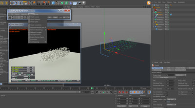

Every time I try making a render of particles using the particle engine option, c4d crashes.
There is no sphere "with render perfect", just a plane and a basic X-Particles setup.

can you post bugreport.zip? some info, renderperfect causes no polygon. also check octane sample scenes. it has some examples for particles. you have some options; best is to use render instances in particles. also particle engine is a experimental option.

Here is the Bugreport.zip
I put very low sample and very few particles.

not really. It's working well here. Can you post your scene?

Here it is.
The problem is maybe coming from the X-Particle version I have...
Thanks !

No crash here. what's the version of XP?

Oh! Interesting.
I have version 2.0.0061, you ?
We're getting somewhere ;)

I was sure that x-particle does not work with octane but no I see that I was wrong
I had old version of x particle and it was crashing, but with last version works nice.
Please help me how to add octane material on X-particle if anyone know.

just put a octane material to emitter. Also may be a sample in demo scenes. Compatibility will be extended for shapes when i found some times
