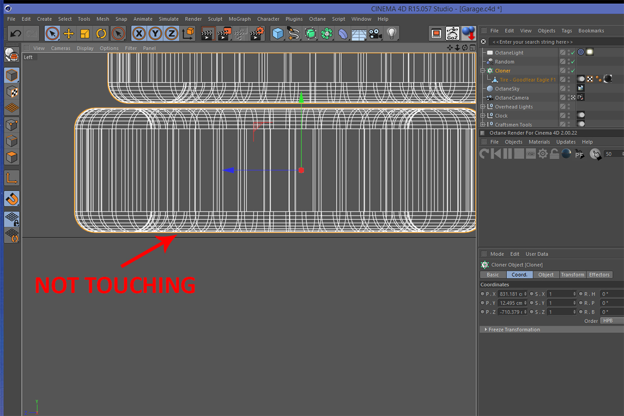

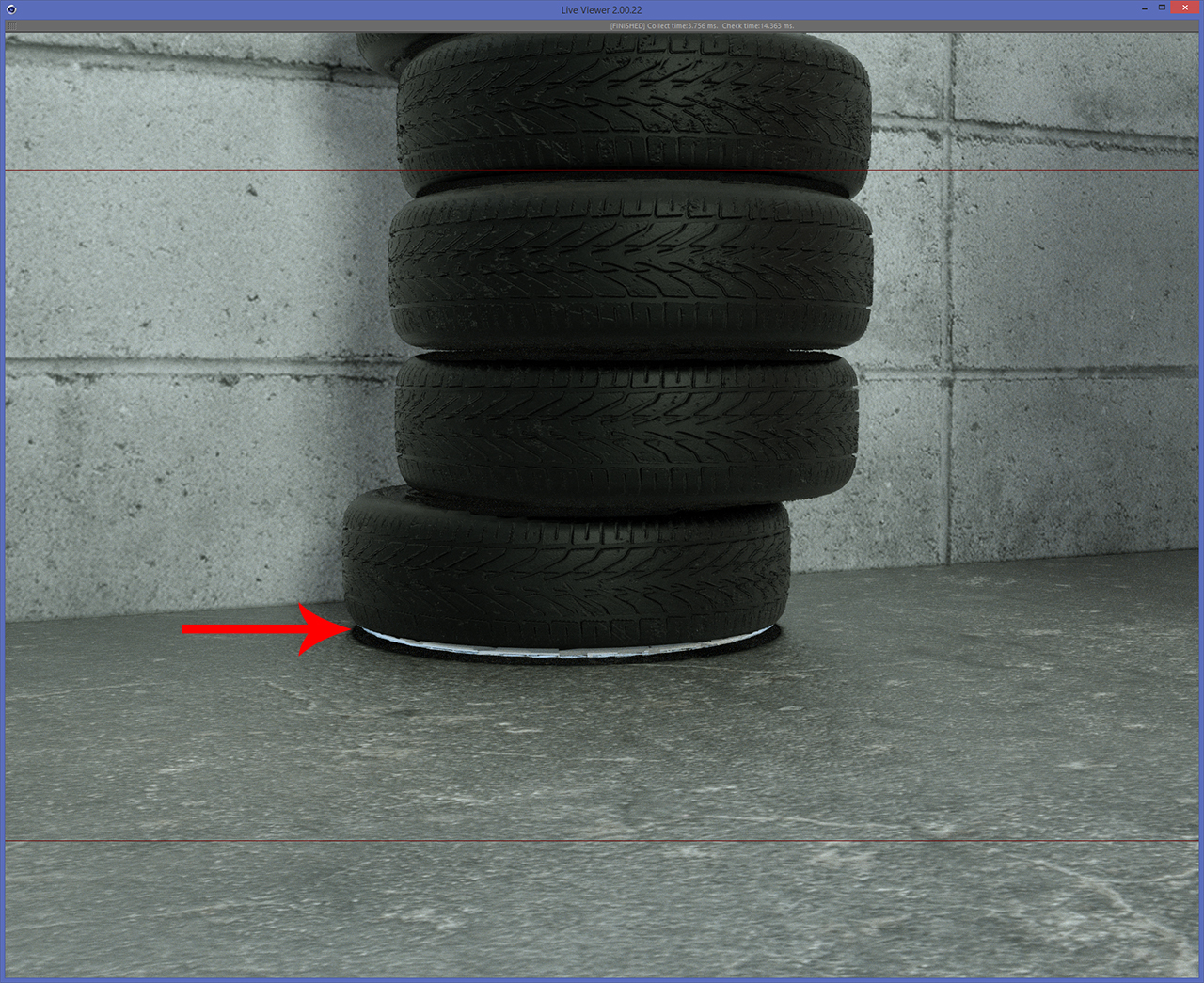

I am having an issue with Octane's Environment. I have geometry that is not touching the floor plane, but is still revealing the HRDI environment. Does anyone know of a way to fix this? Thank you.

To things you can do: Try reducing the ray-epsilon and give your walls and floor thickness.
Posts: 16066
Location: Türkiye
yes, also pls work on real world scaling if you are not doing. This makes that everything is easier and better

abstrax wrote:To things you can do: Try reducing the ray-epsilon and give your walls and floor thickness.
The ray-epsilon parameter worked, thank you! I'll also give the walls & floor thickness for safe measure.
