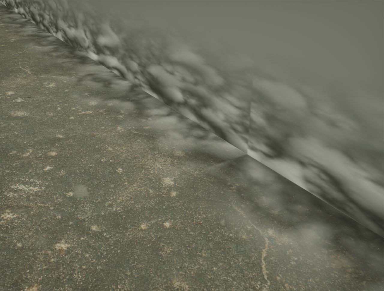

I've tried the method you described and it resulted in the following output. Is there a way to multiply the noise? It seems to be in Normal blend mode. Thank you!

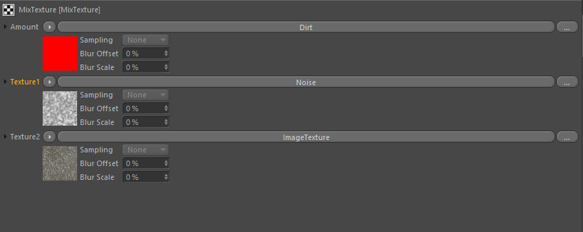

I came up with a solution that I wanted to share.
I created a Multiply node that contained my ImageTexture and a MixTexture node. Inside of the MixTexture is:
  • Amount : Dirt
  • Texture1 : Noise
  • Texture2 : RgbSpectrum set to white
By tweaking the parameters of the Noise and Dirt nodes, I was able to create grunge effects in the corners of my models. Thanks gordonrobb for the help!

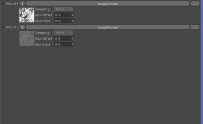

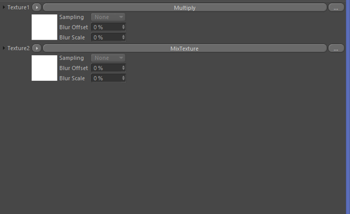

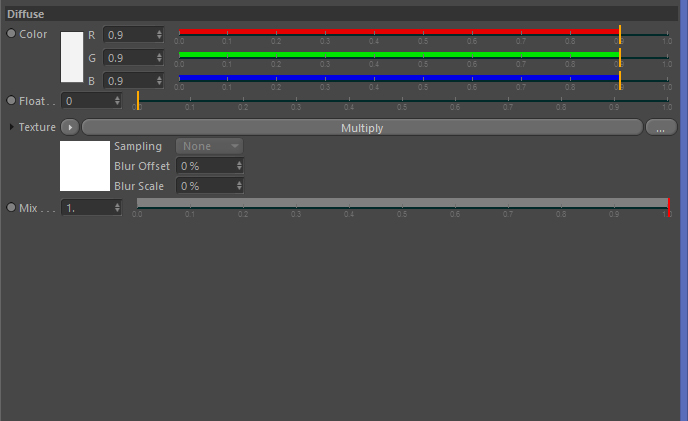

The problem with the image I showed was that the noise was not being multiplied in its blending with the ImageTexture.
Here's my setup for Custom Dirt:
Multiply node within the Diffuse Channel
Multiply & MixTexture nodes within the Multiply node

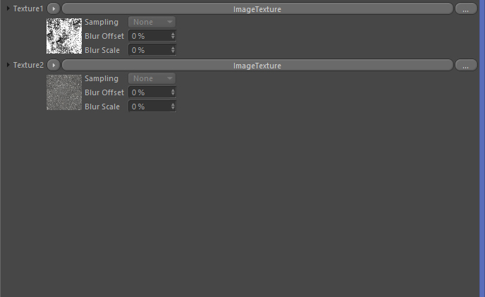

Two Grungy Images within the Multiply node

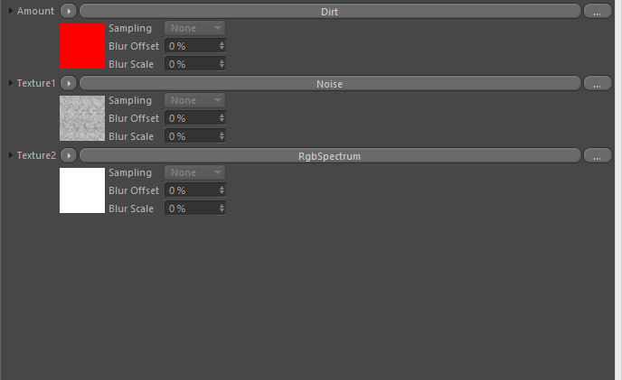

Custom Dirt Map Within the MixTexture node

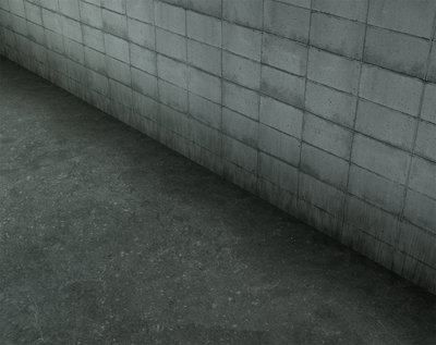

This is the result (there is some ambient occlusion, but the streaking in the corners is created by this custom dirt material.
