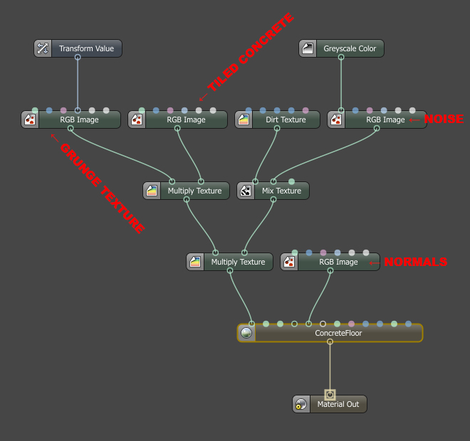

I came up with a solution that I wanted to share.
I created a Multiply node that contained my ImageTexture and a MixTexture node. Inside of the MixTexture is:
- Amount : Dirt
- Texture1 : Noise
- Texture2 : RgbSpectrum set to white

The problem with the image I showed was that the noise was not being multiplied in its blending with the ImageTexture.
Here's my setup for Custom Dirt:

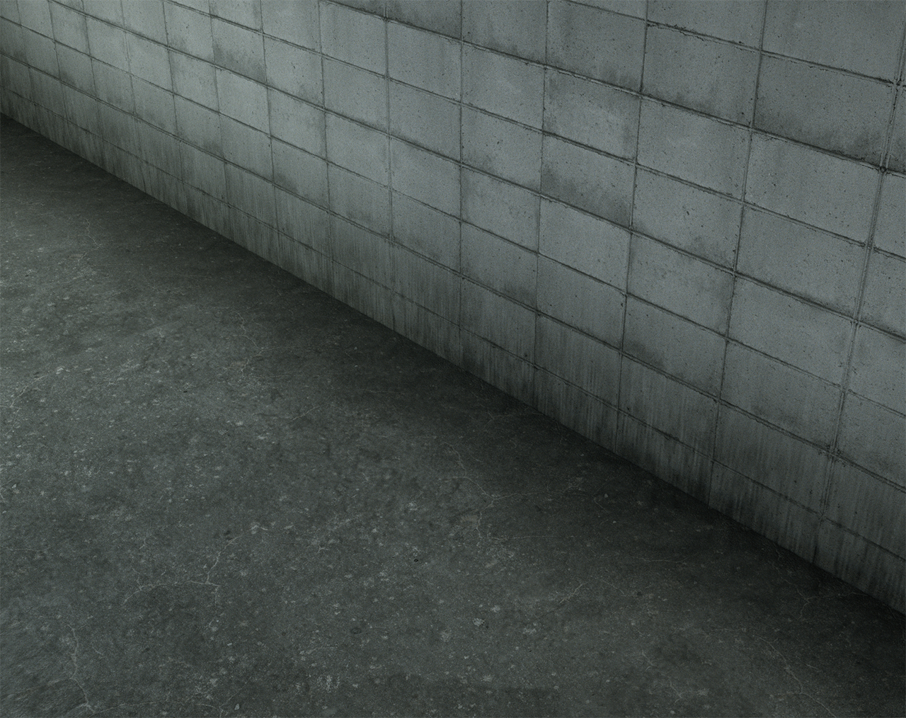

This is the result (there is some ambient occlusion, but the streaking in the corners is created by this custom dirt material.

Looks great, but your images make no sense to me. Doesn't C4D use Nodes? Not being familiar with it, I can't translate it, in my head, to a node tree.
