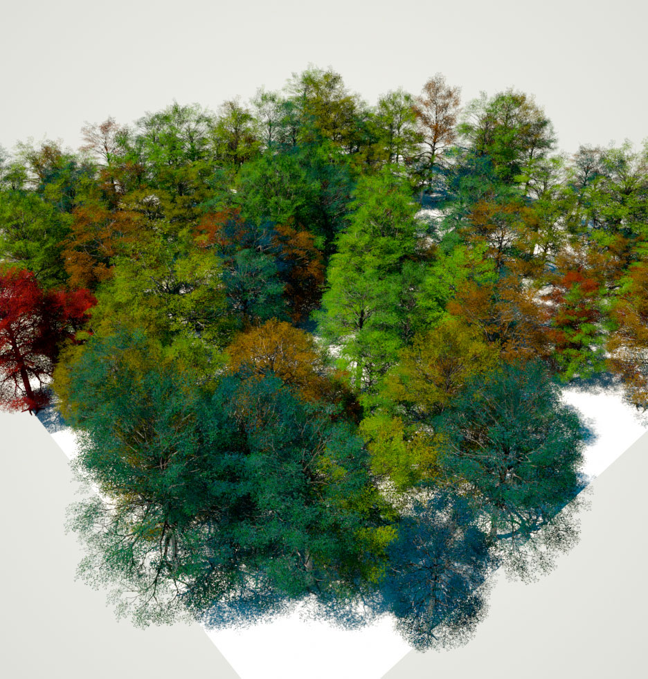

atome451
Posts: 285
Joined: Mon Feb 22, 2010 8:04 pm
Location: Brussels - Belgium
Rudi wrote:
ten wrote:If you open the mblur-dynatest1 project from the 2.0 sample projects here..
http://render.otoy.com/customerdownload ... amples.zip
You can examine the random colour material setup there.
ten
Now I have it ...:)
Only unfortunately, nothing helps for Carbon Scatter to vary the tones.
For me it works. But of course i need to convert C4D materials to Octane (after unlock Carbon Scatter layer).
For the Random Color, you need to add a gradient and a Random Color as Amount, not a mix. I have used a ColorCorrection with a gradient as Brightness and a Random Color as Amount of the gradient for the sample below.
For the sample, i've used funky colors... :D
A sample of Random color with Carbon Scatter.

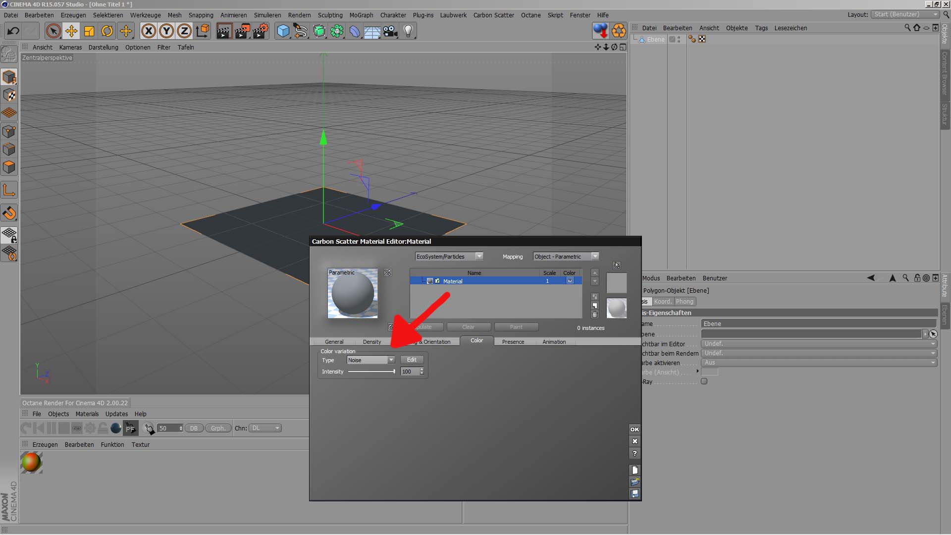

Rudi
Posts: 188
Joined: Sun Sep 01, 2013 7:05 pm
Nice... :)
The variations of the color in CS does not go.
What passes if you to see how in the picture, puts into CS2 Noise with Color.
With the C4D Render everything is in order, but not with the octane Render.
This is my Problem
To see how in this Thread. Unfortunately.: (
http://render.otoy.com/forum/viewtopic.php?f=30&t=40350
atome451
Posts: 285
CarbonScatter is designed to work with the C4D renderer. If you want to use Octane functions, you need to use an Octane material... :roll:
Win10 64bits | 3x 980 + 2x 670 + 1060 | Cubix XPander + network | Core i7 3600 MHz | 32GB | 1300w PSU
