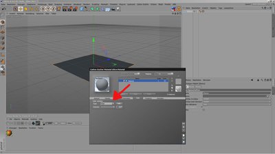

Now I have it ...
Only unfortunately, nothing helps for Carbon Scatter to vary the tones.

For the Random Color, you need to add a gradient and a Random Color as Amount, not a mix. I have used a ColorCorrection with a gradient as Brightness and a Random Color as Amount of the gradient for the sample below.
For the sample, i've used funky colors...

Nice...
The variations of the color in CS does not go.
What passes if you to see how in the picture, puts into CS2 Noise with Color.
With the C4D Render everything is in order, but not with the octane Render. This is my Problem
To see how in this Thread. Unfortunately.: (

CarbonScatter is designed to work with the C4D renderer. If you want to use Octane functions, you need to use an Octane material...
