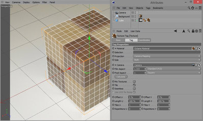

I use C4D Camera Mapping with Octane Material.
When Object Mesh Count is Low. Distorted
cammap.zip
(1.19 MiB) Downloaded 235 times
Simple Scene Setting

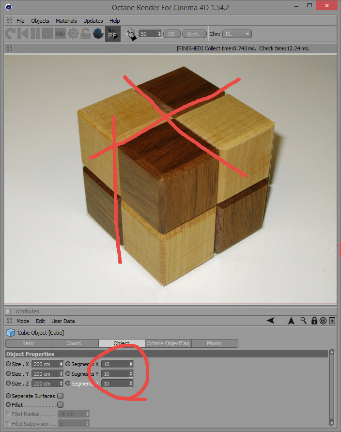

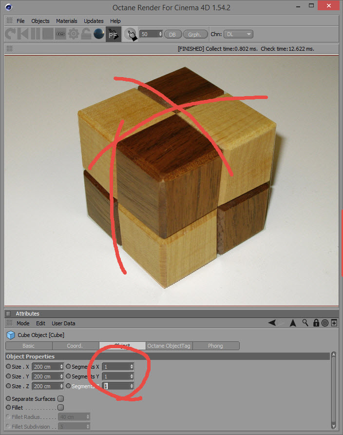

Low Count Mesh : Distort
High Count Mesh : Good

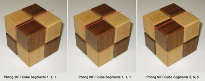

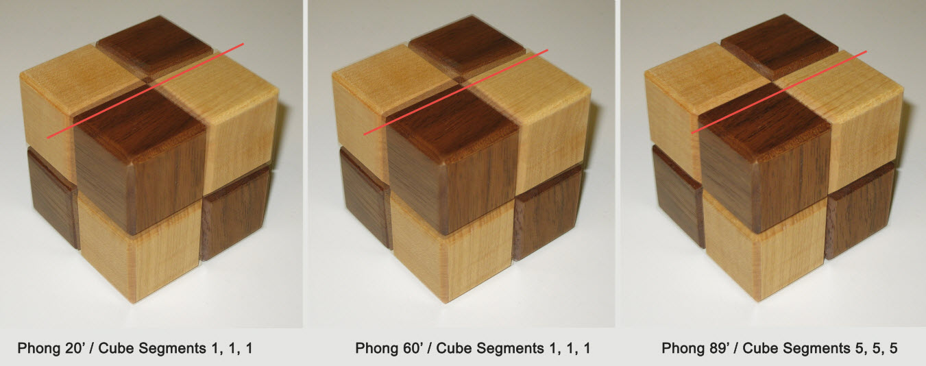

hi,
what happen if you lower the phong angle of the cube at at least 40 or below?
octane is much more sensitive to the phong angle compared to c4d,
ciao beppe

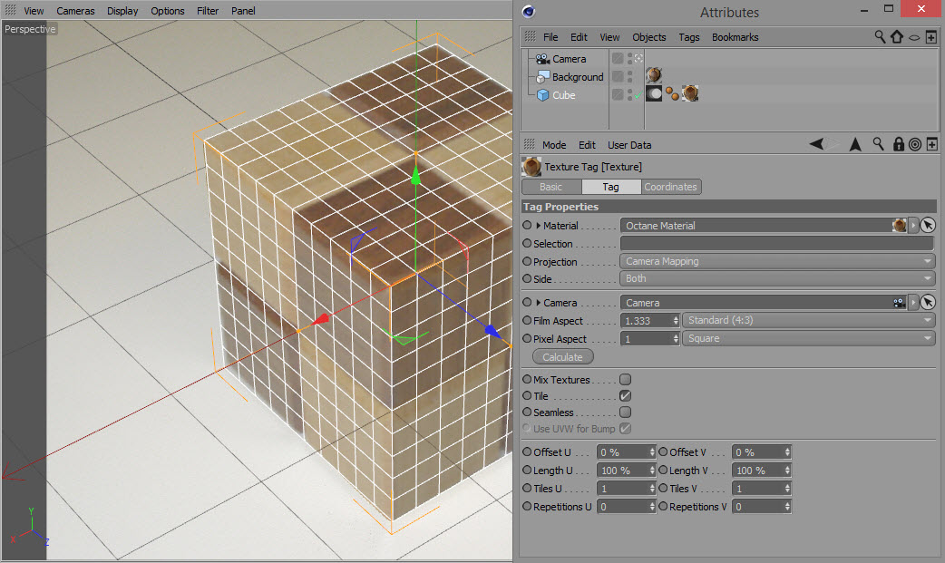

Plz download & Open Sample Scene.
You can See What I Say.
is Not a Phong & Driver Problem. :shock:
Overlay Original Background Image
