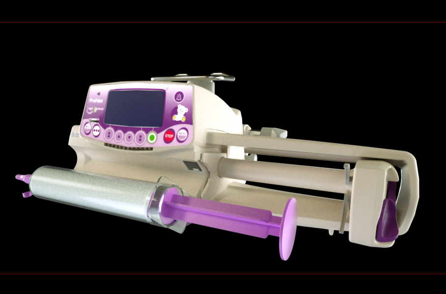

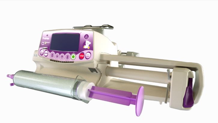

BUG 2 : Rendering a boolean driven by a parent constrain
This time, I'm using a boolean in order to simulate the level of a liquid in a syringue. The cube is linked to the syringue's moving piece by a "Parent Constrain tag".
In the live view, everything is ok, but the boolean isn't working in while rendering.
As soon as I desactivate the constrain, everything looks ok... but I lose my animation process.
Live view
Live view
Render
Render
Posts: 16068
Location: Türkiye
what's your plugin version? try last one. I think you have a object tag on top of object group
