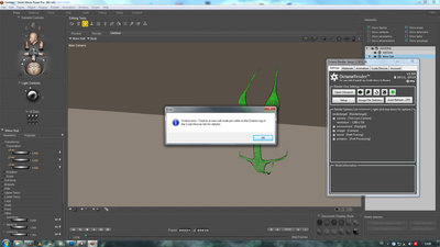

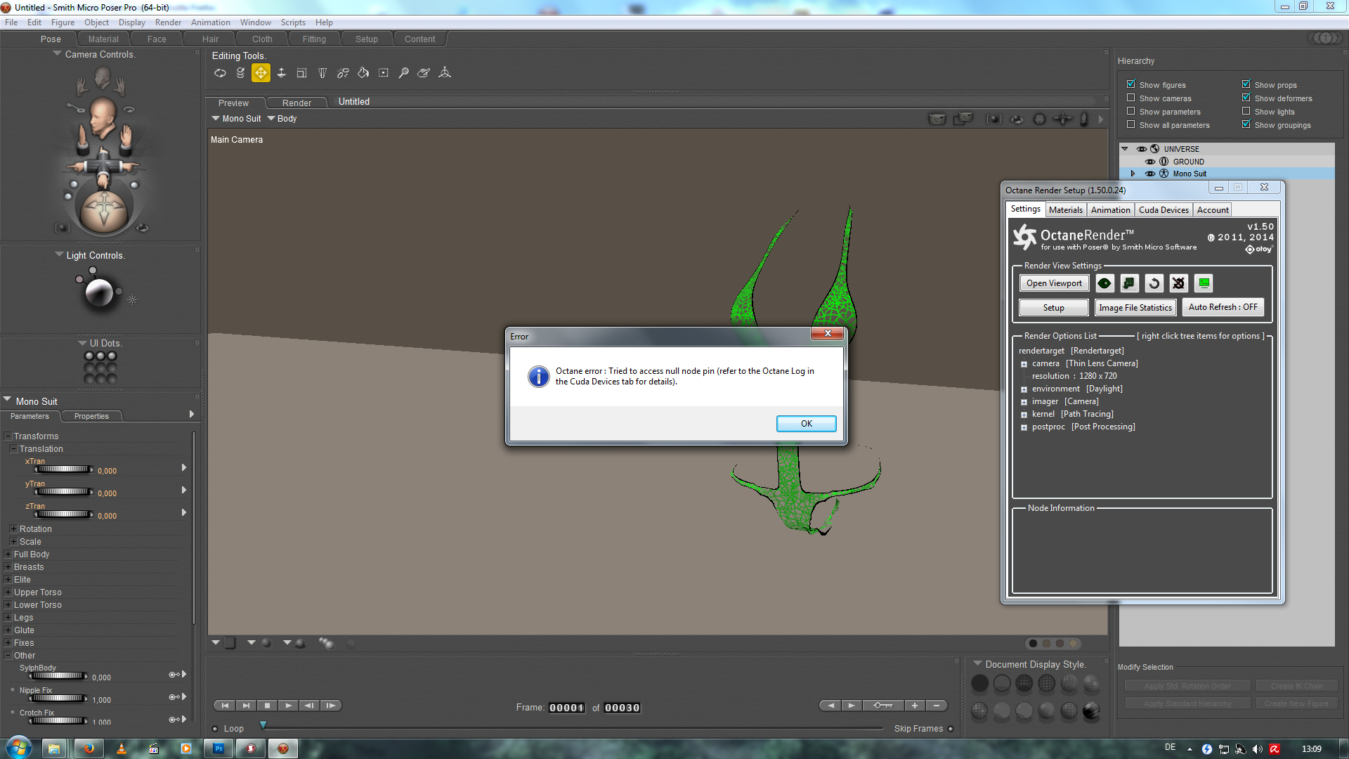

Do I have to do something special to install it?
Do I need to delete something?
I just installed it and when I load a figure I optimized for Octane, it says:
"Octane error: Tried to access null node pin"
And the texture size is is wrong.
I hope I don't have to re-optimize all my custom characters for Octane again.

face_off
Posts: 15822
Location: Adelaide, Australia
The rest of that message directs you to check the Octane Log. What did the Octane log say?
Pls see the first post at http://render.otoy.com/forum/viewtopic.php?f=45&t=37605 for details on the scale differences between Octane 1.20 and 1.50.
Paul
ArminBeier
Posts: 35
Joined: Wed Nov 06, 2013 2:55 am
Node type 7 is either unknown, a linker or incompatible to static pin 'unknown' (P_UNKNOWN, type PT_UNKNOWN) of node '' (NT_UNKNOWN, 000000000D7A8FD0)
- Image, Floatimage and Alphaimage "scale" pins are not compatible with Octane 1.21 so will not be loaded from existing pz3 files. If texturemaps are out of scale for a particular material, "Re-Import From Poser" that material.
So I have to delete all Octane nodes in the Poser material room and convert it again? So all settings are gone.
When I click "Reconvert Materials for this Prop/Figure from Poser" the same error as mentioned above appears.
If I delete all note and reconvert it works, but now I have to make everything again :(

face_off
Posts: 15822
Deane - that looks like a graphics card issue. Was it a particularly big or complex scene? Did you have anything else using the card? Suggest re-booting and trying again.
The version 1.5 plugin is trying to create a version 1.2 node which is no longer supported. This could either be a plugin installation issue, and a plugin code issue. Can you pls re-install the plugin via the Windows Control Panel and then reinstall the 1.5 version and try again? If you still get the error - can you pls send me a small scene which demonstrates the error and I will take a closer look.
In the majority of cases, there is no scaling of the texture in the Poser material - so the Octane version of these will work fine. The plugin will also convert the scale (from plugin version 1.2 to 1.5) if it's not 100% in some cases. So there should only be a very small number of cases where you need to adjust the scale of the texturemap in the Octane material (when using the plugin 1.5 version on 1.2 saved scenes). Again - if you have a particular scene where the textures are incorrectly scaled, send it to me and I will investigate further.
Hope that helps.
