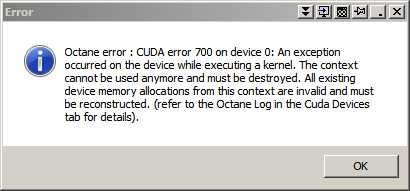

Latest error message... but Octane didn't crash on me.
Started logging on 05.04.14 04:53:57
OctaneRender version 1.50 (1500001)
CUDA error 700 on device 0: An exception occurred on the device while executing a kernel. The context cannot be used anymore and must be destroyed. All existing device memory allocations from this context are invalid and must be reconstructed.
-> Kernel execution failed (wppick)
CUDA device 0: White point picking failed
-> Failed to load symbol data to the device (kernel data)
CUDA device 0: Path tracing failed
-> Failed to copy memory to device.
CUDA device 0: Failed to load data of data texture 20 of context 0 onto device
-> Failed to deallocate device memory
-> Could not get memory info
-> Failed to launch kernel (clear)

Deane - that looks like a graphics card issue. Was it a particularly big or complex scene? Did you have anything else using the card? Suggest re-booting and trying again.
Hope that helps.
Paul
