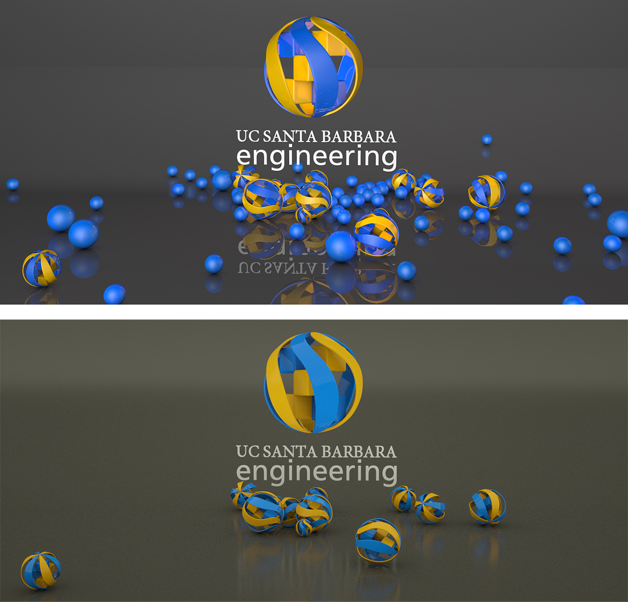

I created a metaball animation in Cinema and some of the animation uses spheres put through a cloner operation do not show up in the octane render. The metaball object does but these cloned spheres do not. Is there something I can do inside Cinema to turn these into meshes that Octane Render will see?
I also notice when I render a sequence of an animation that the first frame that renders is the full 2500 samples that I assigned but any after that are 128 samples or 144 samples. It is not consistent... it just rattles through the rest of them at a much reduced sampled count.

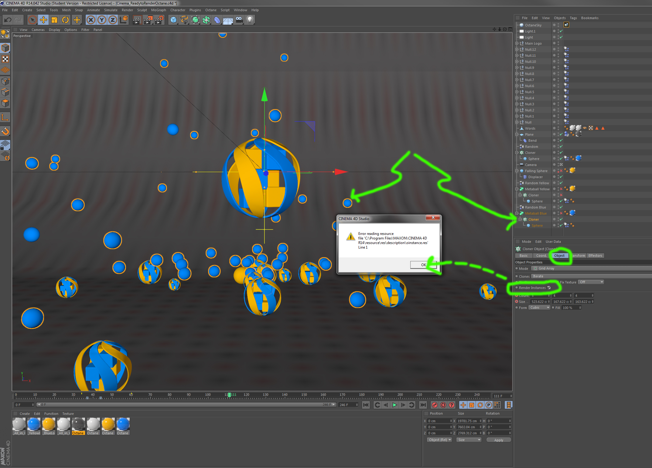

i don't understand, can you pls show me a few pictures? I think you have corrupt c4d install
p3taoctane
Posts: 1418
Joined: Mon Jan 25, 2010 12:53 am
You bet.
When I select Render Instances I get that error.
I am not sure if that button is a render instances OCTANE setting or a CINEMA one though???
Peter
Posts: 16068
Location: Türkiye
yes, this is for render instances. But why this gives error? What happens without octane install?
