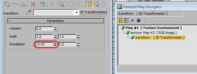

How to i rotate my Texture Environment? With the new version, the Rotataion option has gone.
The texture 2D Transformation rotates the Image about the wrong axis...

Use translation X instead to rotate environment map.

gueoct wrote:How to i rotate my Texture Environment? With the new version, the Rotataion option has gone.
