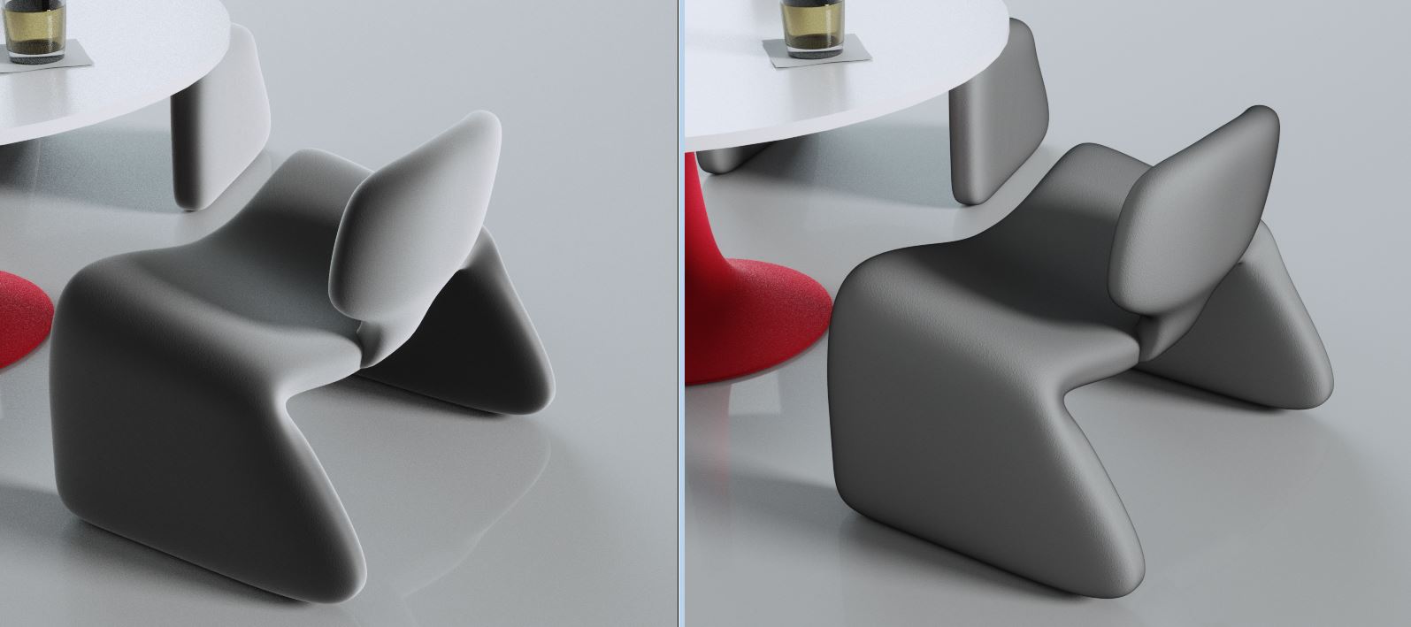

- hm.. good info..
- I tried using the invert texture node after the falloff node - yes it does that, but you have to change the settings of the falloff, you could probably try the color correction node, it has a invert setting as well
the one on the right is inverted
