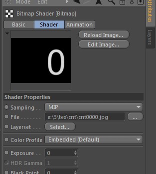

absolutely,
look this and you'll see a example. Use c4d bitmap instead of octane imagetexture. for animated sequences
http://render.otoy.com/forum/viewtopic.php?f=30&t=36303

Posts: 16068
Location: Türkiye
try absolute paths as image, there is a problem on relatives
