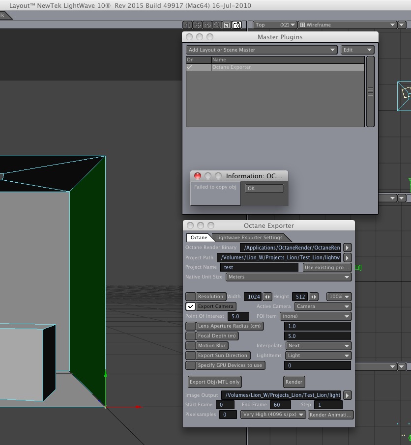

tested 0.2b now again on mac. same issues. 'failed to copy obj' followed by 'failed to copy mtl'.
everytime, no matter if a single object or a more complex scene.
i'm using use all default settings, just the exporter settings are set to 'lightwave OBJ export (hc only)'.
Same issue if i use the 'export obj/mtl only' button.
LW build 2015, osx ub 64 bit, on mac osx 10.6.3.

3dworks wrote:tested 0.2b now again on mac. same issues. 'failed to copy obj' followed by 'failed to copy mtl'.
attachments: screenshot + object which i tried to export.
Do you have ngons? Also I think only one layer in layout is possible for now.

geo_n wrote:...
thanks for advice, missed that one.
however: removed layers and ngons, but have still the same issue.
