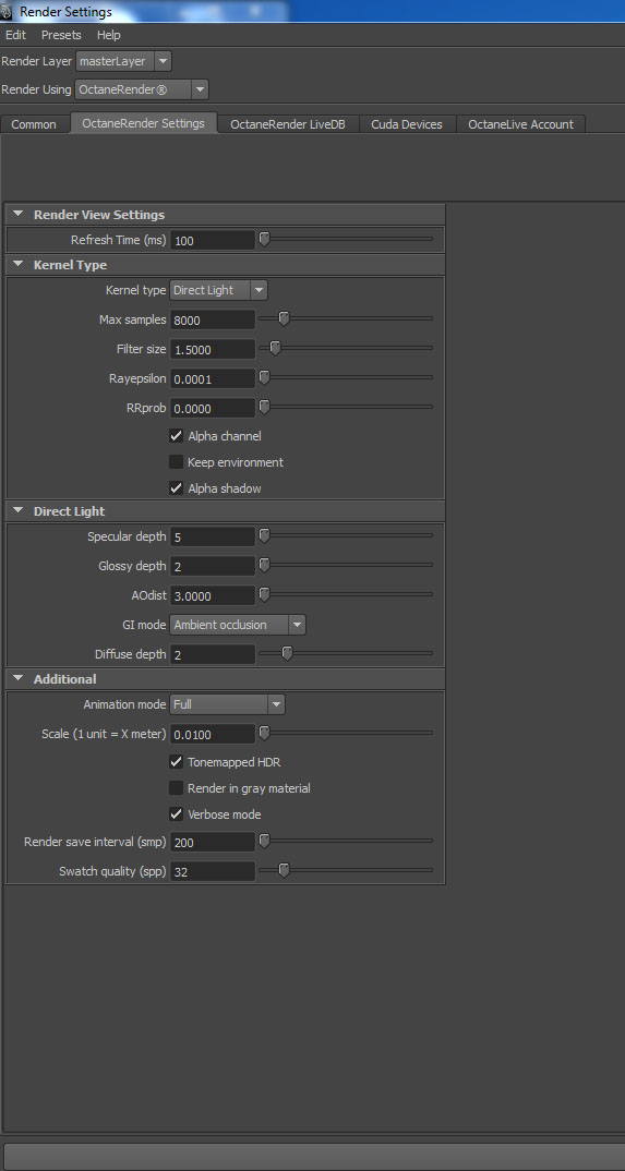

Please, enable "Verbose mode" in Octane settings, delete mayaRenderLog.txt before starting batch, and then post here this mayaRenderLog.txt created after batch is finished. Your Octane settings will be needed too, you can post the screenshots of settings tabs here.

Hi, and thanks so much for the prompt reply. I took the screenshots & reset / ran the .txt file before I headed off to work today, so hopefully this will give you the info you need.
