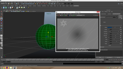

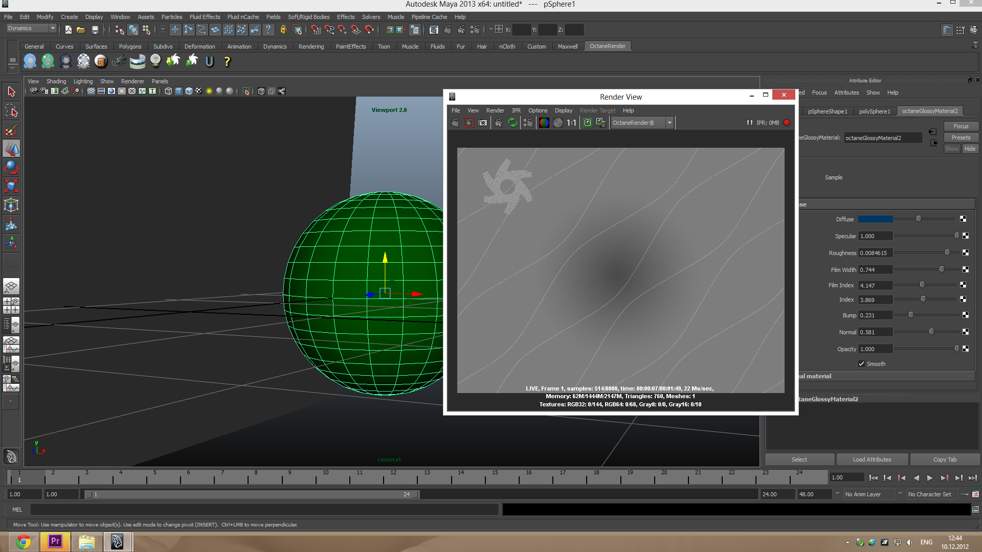

Hi, thanks for demo. But i have some troubles
What`s wrong? I set sun/sky , gpu - ok, in render settings. Applied glossy material to sphere. Where i wrong?

Freyr wrote:Hi, thanks for demo. But i have some troubles
Camera. Set Octane camera aperture and/or focus.

I tried to play with camera settings, and it make some result. But, anyway, it looks like you know what.
range of numbers - gigantic, i have no idea how to make standart camera settings. And what`s wrong with light?
? Plus - please remove this number range, make it smaller. it is inconvenient for work with it, you want to set to 100, but you are setting 1000. Like this. (
ps - you can set "100" with shift pressed, but only in channel box, not attrib editor)

Freyr
You can pick the exact focus by selecting the region in the RenderView during IPR (the current camera focus will be set to the center of this region).
Set the scale to 1.0 in the Octane settings.

Thanks! now i see more results.
Anyway, i hope you`ll make a smaller default number ranges + what about smooth mesh preview?
VERY important thing, because a work with highpoly uv`s - suicide
