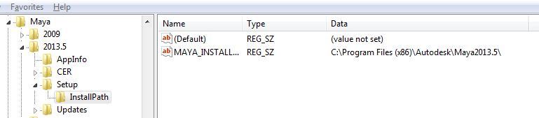

Can you check the MAYA_INSTALL_LOCATION key in the registry at path HKLM\SOFTWARE\Autodesk\Maya\2013\Setup\InstallPath, what value it has? Or perhaps you do not have this path and have the HKLM\SOFTWARE\Autodesk\Maya\2013.5\Setup\InstallPath instead?..

Sorry, in you case this path should be like HKLM\SOFTWARE\Wow6432Node\Autodesk\Maya\2013\Setup\InstallPath for x86 Maya installations...

JimStar wrote:
phaskins wrote:No....
However my path would be C:\Program Files (x86)\Autodesk\Maya2013.5\bin\plug-ins
I'm wondering if the install is getting confused because of the .5 on the end of the Maya2013 folder name.
Installer gets the path from the registry.
