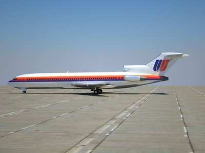

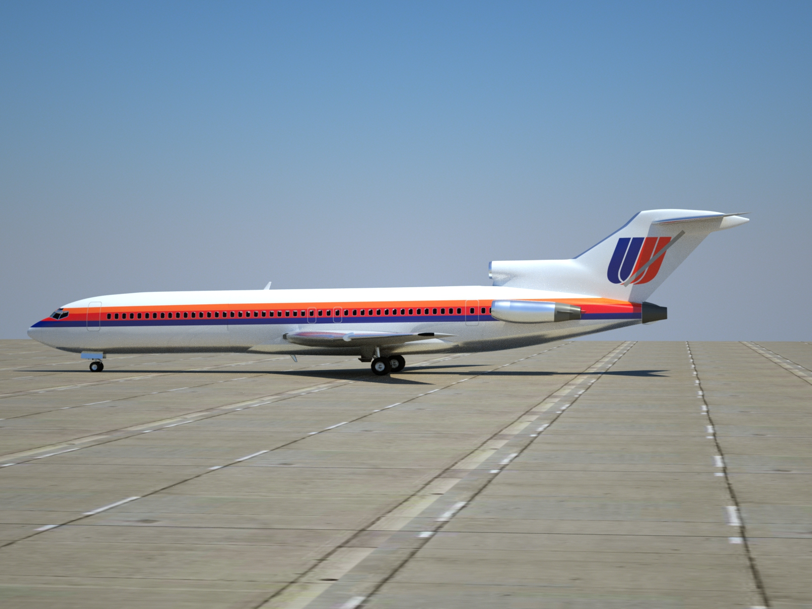

If you're talking about the physical sky, then I would just suggest you to change some random values on it, play with it till you have a good result, as you need the sun to light your model; HDRI maps don't support Sun at the same time yet.

I was afraid of that....needed some clouds.....will have to wait until Octane supports HDRI and sun.

render with alpha and put your sky.

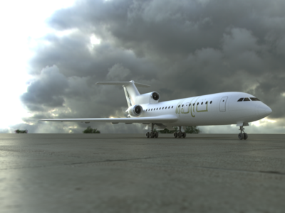

did yesterday

Ok, I think this is what I need....under the Mesh Preveiw Kernel....I enabled the alpha channel and the sky disappears...so far so good. But when I attatch a png image the error I get says no alpha channel in image. What kind of image would need to be connected to the alpha channel pin in the mesh preview kernel?

Elvissuperstar007 wrote:did yesterday
Very nice work, how did you get the sky in the back? I think I am almost there just not sure what type of image is required yet.
Nice image ! I think that the best way for now is to use the Daylight system to create specular effects and get a shadow on the ground in the wanted direction, and render with alpha (transparent background).
Render again (still with transparent background) with an HDR or LDR image as environment if you want to get some sky/cloud reflections on the airplane.
Composite the two layers and adjust the mix amount to get the desired effect.
Add a background photo with the sun in the same direction as the sun direction in the Daylight system.

ROUBAL wrote:Nice image ! I think that the best way for now is to use the Daylight system to create specular effects and get a shadow on the ground in the wanted direction, and render with alpha (transparent background).
Great info! How do you add the backround photo, is that done in Octane or outside of Octane in Gimp or Photoshop?
boeing727223 wrote:ROUBAL wrote:Nice image ! I think that the best way for now is to use the Daylight system to create specular effects and get a shadow on the ground in the wanted direction, and render with alpha (transparent background).
That needs to be done outside of Octane.
