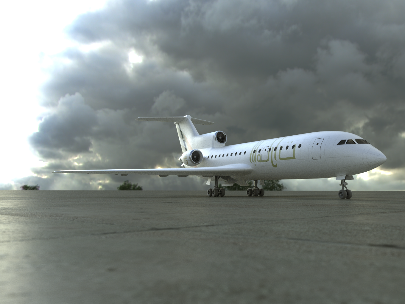

did yesterday

Elvissuperstar007 wrote:did yesterday
Very nice work, how did you get the sky in the back? I think I am almost there just not sure what type of image is required yet.
Nice image ! I think that the best way for now is to use the Daylight system to create specular effects and get a shadow on the ground in the wanted direction, and render with alpha (transparent background).
Render again (still with transparent background) with an HDR or LDR image as environment if you want to get some sky/cloud reflections on the airplane.
Composite the two layers and adjust the mix amount to get the desired effect.
Add a background photo with the sun in the same direction as the sun direction in the Daylight system.

ROUBAL wrote:Nice image ! I think that the best way for now is to use the Daylight system to create specular effects and get a shadow on the ground in the wanted direction, and render with alpha (transparent background).
Great info! How do you add the backround photo, is that done in Octane or outside of Octane in Gimp or Photoshop?
boeing727223 wrote:ROUBAL wrote:Nice image ! I think that the best way for now is to use the Daylight system to create specular effects and get a shadow on the ground in the wanted direction, and render with alpha (transparent background).
That needs to be done outside of Octane.
