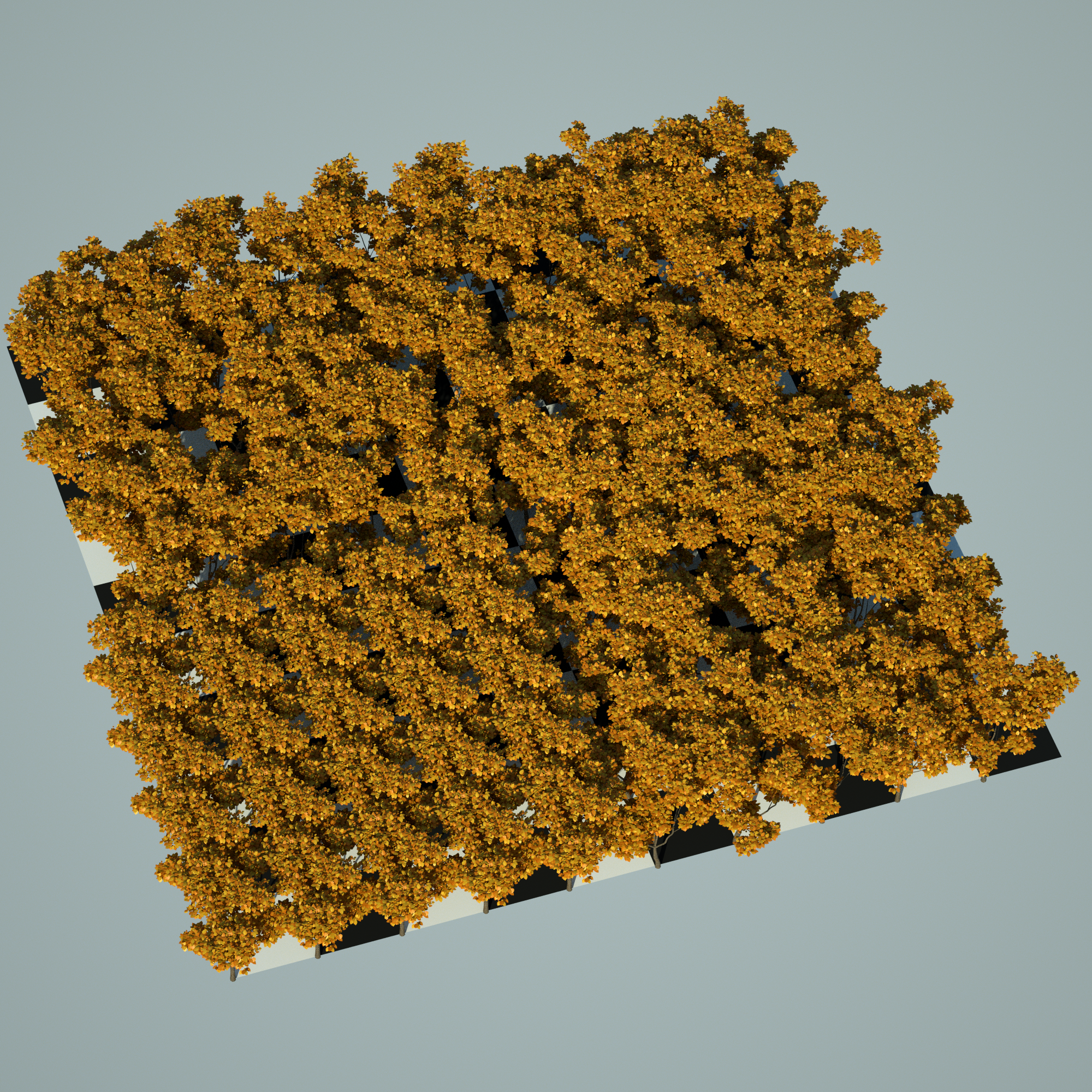

i add a sample that is the result of using the plugin "Grasshopper" for the determination of the matrix, for exact positioning of the instances in Octane Render by scatter node.
A big thanks for the support David Rutten (McNeel) who created the script for Grasshopper.
Ciao

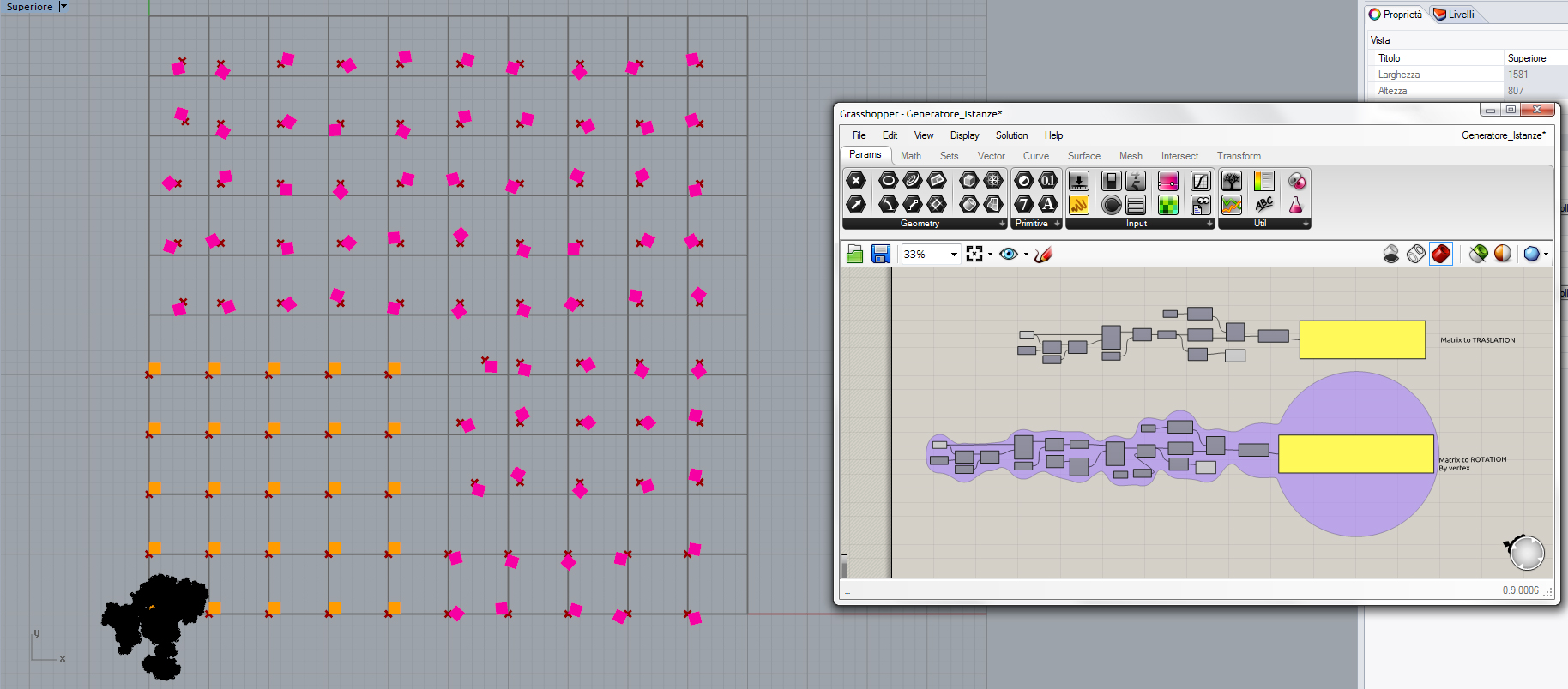

i can share all you want but not the script because i don't know how to do...
I add the definition of grasshopper that there is the script...
I hope i can help you...

Update:
    Now also works with items that have different Z coordinates
    IMPORTANT!!! You need the last version of rhino 4/5 and Grasshopper

    There is a small problem but do not know how to fix it:
    I changed the definition of grasshopper to scale objects a random, but the array that creates not take it into account, so unfortunately all instances have the same height.
    You can import several object of different heights and with different octane nodes scatter you assign different positioning matrix.
    A little intricate but at the moment I see no other solution
