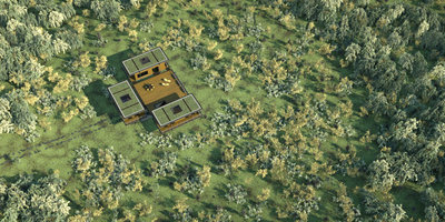

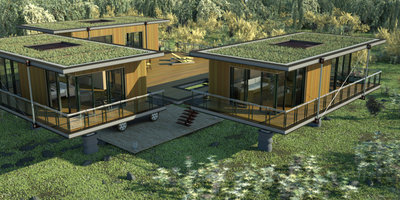

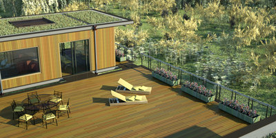

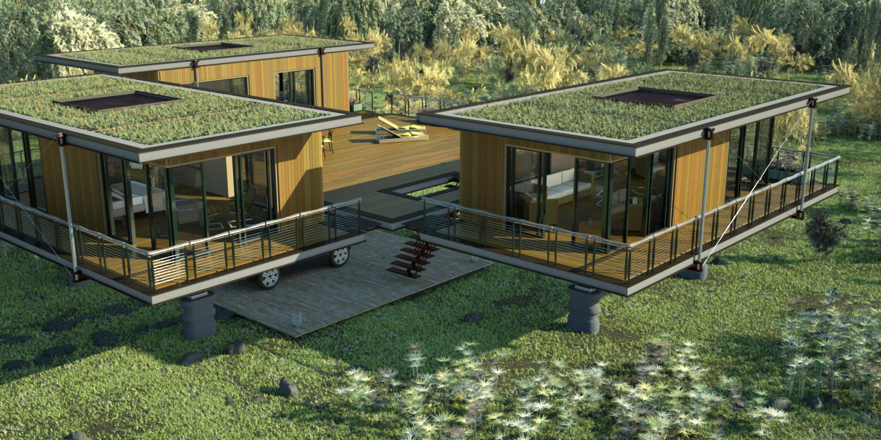

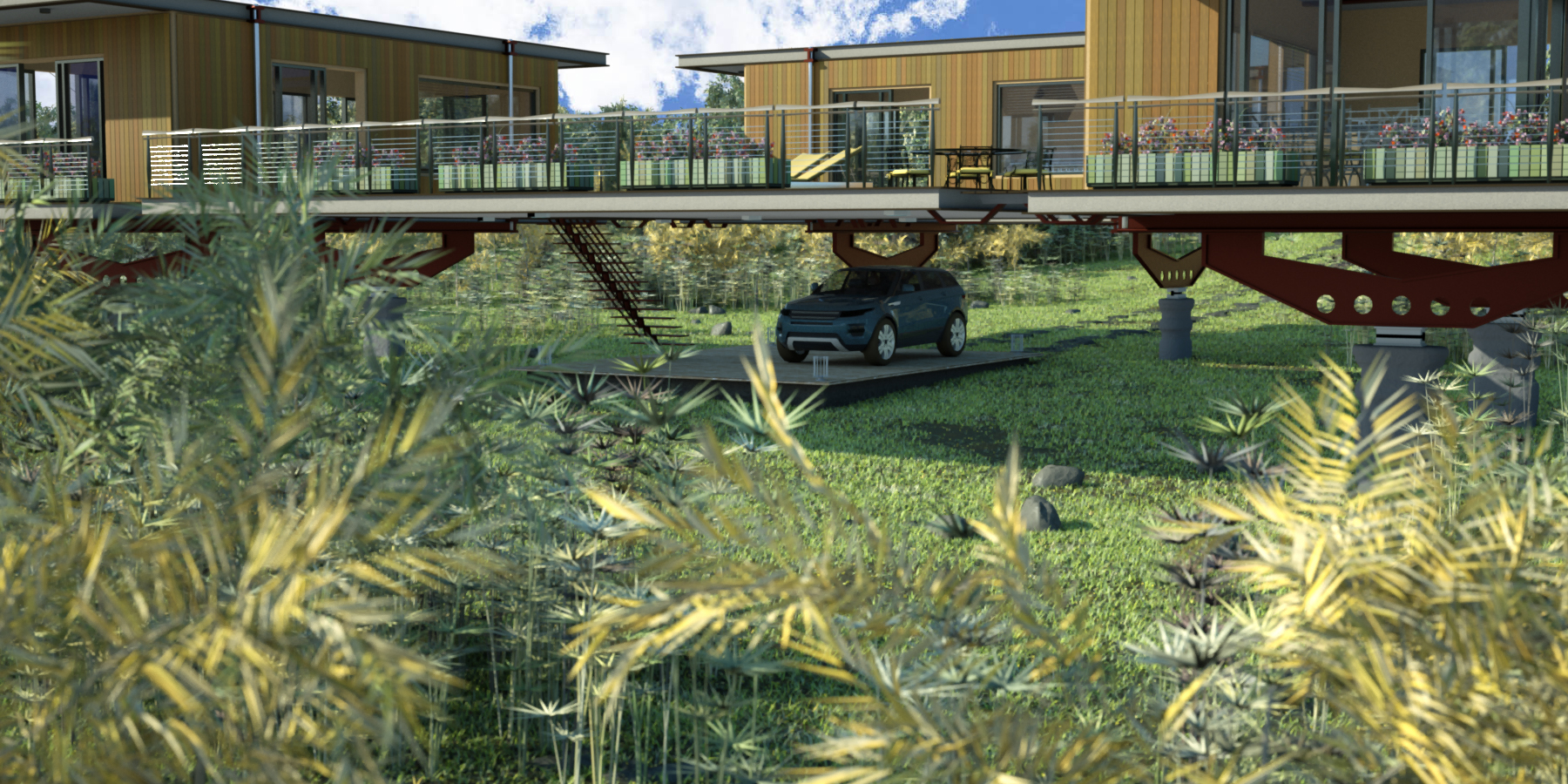

Dear all,
Thanks to new beta instancing feature, was able to do things from Sketchup impossible before.
Your feedbacks regarding plants and grass welcome.
Yours
Pascal

Textures & models looks good to me.
But what disturbs me the most, is the lighting. I don't know how to describe but it looks washed up/bland or something like that.
Like an old render compared to what Octane can do.
What kernel did you use? Direct Lighting only?

I just use the Sketchup ruby script discussed in this thread http://render.otoy.com/forum/viewtopic.php?f=31&t=22581
Thanks to TIG and SMICHA for sharing their work on this.
You will also find a tutorial within the same forum topic.
Hope the feature will be integrated in the future into Octane SU exporter.
Also use some small SU tweaks to avoid SU performance issues when handling too many instances of hipoly components : replacing complex components within SU by much more simpler ones (just a cube or a line) when creating the scene, and creating different SU files each one with only one instance of the final obj component to export.

I agree with Ice, it looks like an older render made this. I would recommend a good HDRI for the scene and play with materials a bit more. I've seen direct lighting renders that were pretty damn realistic so you might be able to get away with it here. Although pathtracing is probably the best solution for a wide outdoor scene such as this.
