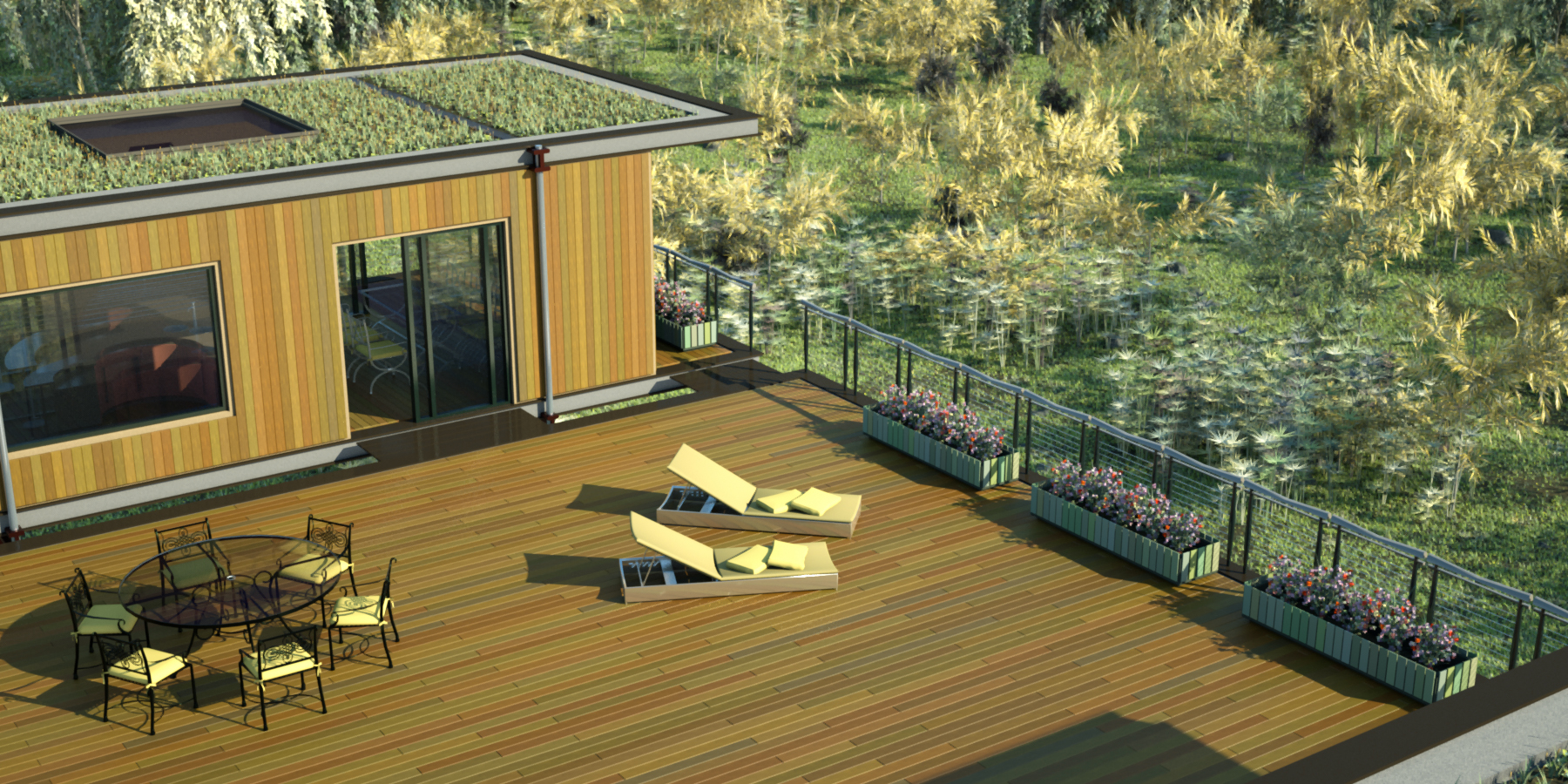

Dear all,
Thanks to new beta instancing feature, was able to do things from Sketchup impossible before.
Your feedbacks regarding plants and grass welcome.
Yours
Pascal

Textures & models looks good to me.
But what disturbs me the most, is the lighting. I don't know how to describe but it looks washed up/bland or something like that.
Like an old render compared to what Octane can do.
What kernel did you use? Direct Lighting only?

Yes these are directlighting only with octane daylight.
I need to try other render engines with hdri images.
And maybe to more leaves are ligth colors. Will try to add more dark colors on the leaves.

I agree with Ice, it looks like an older render made this. I would recommend a good HDRI for the scene and play with materials a bit more. I've seen direct lighting renders that were pretty damn realistic so you might be able to get away with it here. Although pathtracing is probably the best solution for a wide outdoor scene such as this.
