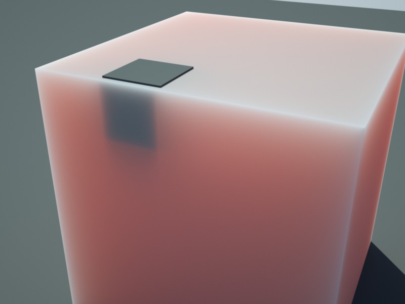

I have made an example.
SSS box in the scene should have 1m x 1m x 1m size for correct result.
DiffuseSSS.zip
(16.89 KiB) Downloaded 232 times

Karba thx for that simple scene..but i need to know 1 thing, is it possible to feel the SSS effect using Direct light and AO? if so would u mind sharing the same simple scene with DL and AO? im trying out this scene as it is and it only works with either DL, DIFF or just PT.
