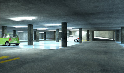

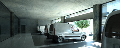

there are some pictures of my last architectural project. it`s for a competition. because i was short in time (most of the effort was concepting the building) there is absolutely no photoshop and the rendertimes were quite short. the rendertimes would be the main reason for the noise in some areas.
its not really finalized but i hope for the actual state of the project the pictures will meet demands ;-)

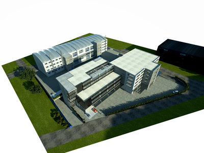

perhaps interesting for you, 3d-model

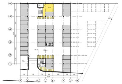

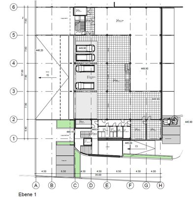

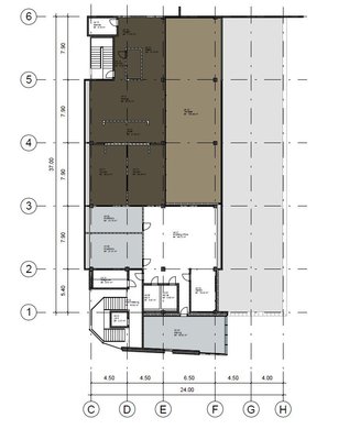

perhaps interesting for you, floorplan 04
perhaps interesting for you, floorplan 03
perhaps interesting for you, floorplan 02
perhaps interesting for you, floorplan 01

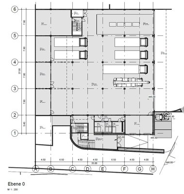

perhaps interesting for you, floorplan 00
perhaps interesting for you, floorplan -1

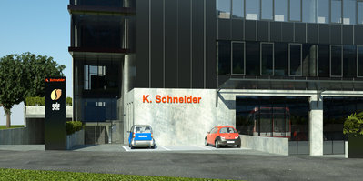

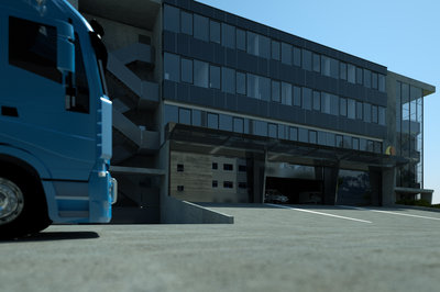

Hello Huebner!

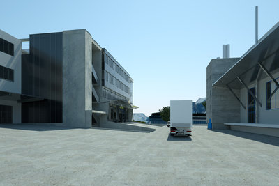

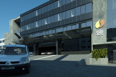

I am really impressed with the outdoor pictures!

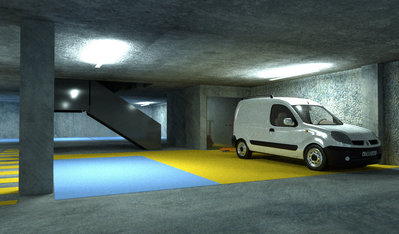

AP08-11 look like real photos, especially when looking at it the first time!
IP10-1 is also very well done, but where does the hotspot on the right wall come from?
AP01 seems to need some texture tweaking for the concrete, maybe just darken it a bit or a little gradient? It looks a bit unnatural cause it is too flat, especially in the bottom behind the shrubs. I think you know how to tweak this. Would you mind to share your texture settings for doing a gradient on it, because I am new to octane and didn`t get too much into materials yet.

hello chrisvis
thnx for your input.
your are right i could get more out of materials and textures. what do you mean with gradient? texturing was made with a simple image of concrete, maybe i forgot to add a bump. perhaps thats the reason why i looks to flat.
all the pictures (about 30) were made (camera, lightsetting & rendered) in about 24hours (kepler test build and 2 x gtx 680). hope a real version for gtx 680 will come out soon. texturing was made in cinema 4d. i didn`t spent more time on materials afterwards in octane.
ip10-1 was the only picture which rendered a bit longer, overnight means about 4hours. no time for sleep a this moment ;-)
dont ask me where the hotspot comes from? maybe there is a child in the kitchen on the left playing with his torch...?
i really dont know but i think the hotspot looks interesting and i didn`t care.
here are some more pictures, you can see whole the 3d model in axo 01.

Hi Huebner,
with gradient I mean, that when looking at a concrete wall of a building in reality, (Picture AP01) the top of the Wall would definetly be a bit more brighter than the bottom of the wall next to the floor... maybe because of ambient occlusion?
I don`t know, if you would achieve this with bump mapping.
In Cinema 4D I use a normal black to white gradient in the diffuse channel, change it from U to V or diagonal, and mix it in 10%, that gives a bit more of a volumetric look, but maybe not the best way to do it.

if you ask me in octane all this light-support texturing is not needed anymore. looks physically correct & realistic without doing this. there is another reason why the wall in ap01 is bright on the bottom. it goes further down to the ramp of the garage.

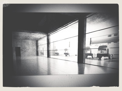

Nice stuff going on here. For the noise on indoor you could do some gilm-effects with cross-processing in photoshop so it looks a bit artistic and like one of those instagram edited pictures. ;)
You only used skylight with your cut-out mountains and a sun for exteriours? or also a HDRI image?

thanx for input. i like artistic look! see below ;-)
...or maybe a longer rendertime would clear up the pictures....
i didn`t use hdri, but i normally build up some neighborhood-buildings. this makes a similar effect, and also realistic reflection in windows & shadows on and beside the new building.
for me as an architect skylight is perfect because i get a idea of light situation. all in realtime at any date and any time. sometimes if necessary i can adapt the concept of the building.
the background is a photo of the building site with a simple alpha. do you know if i could do the same thing with a hdri of the whole surrounding, and then load it in occtane? and is it possible to combine it with skyligt. i think it is not possible.

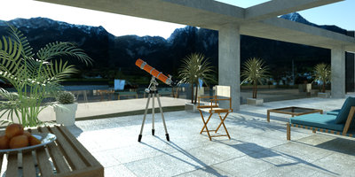

I love shot E1. Where do you get the photo frame?

....simple app for iphone ;)
cause i was too lazy i just took photos of my screen.
