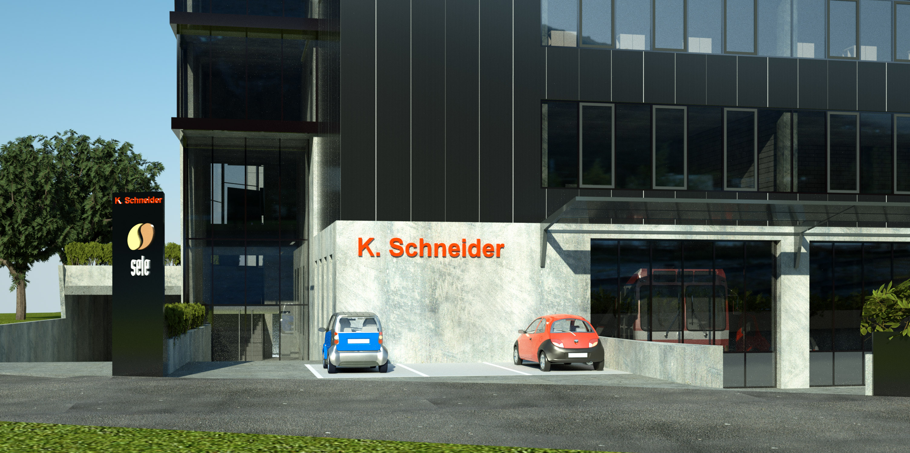

there are some pictures of my last architectural project. it`s for a competition. because i was short in time (most of the effort was concepting the building) there is absolutely no photoshop and the rendertimes were quite short. the rendertimes would be the main reason for the noise in some areas.
its not really finalized but i hope for the actual state of the project the pictures will meet demands
I am really impressed with the outdoor pictures!
AP08-11 look like real photos, especially when looking at it the first time!
IP10-1 is also very well done, but where does the hotspot on the right wall come from?
AP01 seems to need some texture tweaking for the concrete, maybe just darken it a bit or a little gradient? It looks a bit unnatural cause it is too flat, especially in the bottom behind the shrubs. I think you know how to tweak this. Would you mind to share your texture settings for doing a gradient on it, because I am new to octane and didn`t get too much into materials yet.

your are right i could get more out of materials and textures. what do you mean with gradient? texturing was made with a simple image of concrete, maybe i forgot to add a bump. perhaps thats the reason why i looks to flat.
all the pictures (about 30) were made (camera, lightsetting & rendered) in about 24hours (kepler test build and 2 x gtx 680). hope a real version for gtx 680 will come out soon. texturing was made in cinema 4d. i didn`t spent more time on materials afterwards in octane.

with gradient I mean, that when looking at a concrete wall of a building in reality, (Picture AP01) the top of the Wall would definetly be a bit more brighter than the bottom of the wall next to the floor... maybe because of ambient occlusion?
I don`t know, if you would achieve this with bump mapping.
In Cinema 4D I use a normal black to white gradient in the diffuse channel, change it from U to V or diagonal, and mix it in 10%, that gives a bit more of a volumetric look, but maybe not the best way to do it.
I dont know, if this is possible with octane, maybe with the mixed material? Or you need to go into the nodes, I think there you have endless material setting capabilities, but I didnt try it yet. Just read the manual once and will have to learn a lot.

if you ask me in octane all this light-support texturing is not needed anymore. looks physically correct & realistic without doing this. there is another reason why the wall in ap01 is bright on the bottom. it goes further down to the ramp of the garage.
thanx for the reply, your answer to ap01 makes sense.

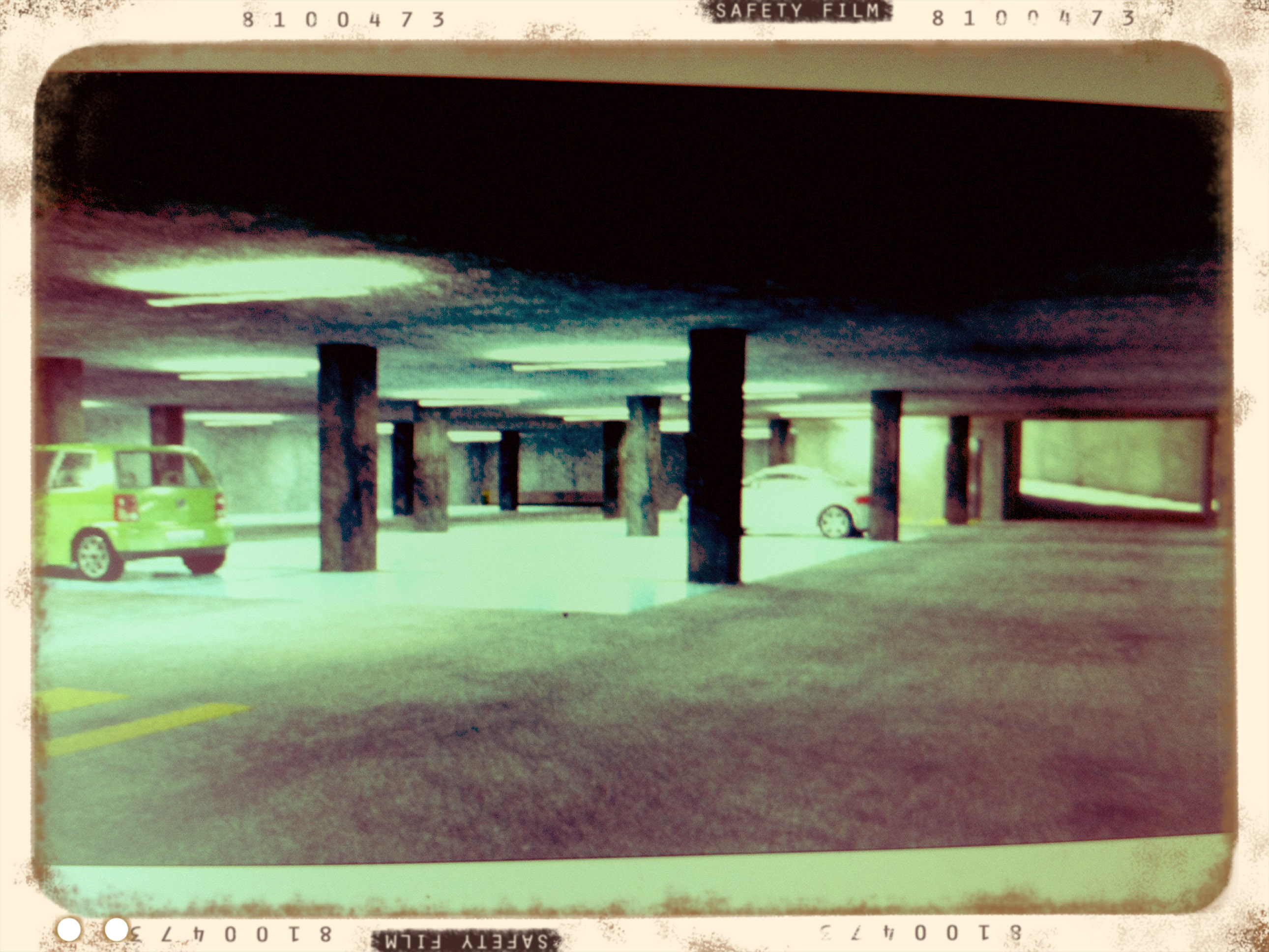

Nice stuff going on here. For the noise on indoor you could do some gilm-effects with cross-processing in photoshop so it looks a bit artistic and like one of those instagram edited pictures.

thanx for input. i like artistic look! see below
...or maybe a longer rendertime would clear up the pictures....
