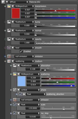

Thank you for the help. But these threads doesn't help me. I tried to reproduce what roeland did here: http://refractivesoftware.com/forum/vie ... scattering
If i add a Float Texture it doesn't connect with the material which i want to be a sss material. Also the render doesn't rerender the picture if i change something in the absorption options. Maybe a explanation will help here.

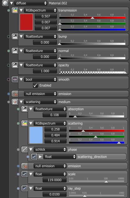

You need to take a close look at the screenshots for a diffuse material in http://refractivesoftware.com/forum/vie ... =21&t=9380. Make sure you connect a node to the transmission node pin (the second from the left). The color should be similar to the reflection input, but as bright as possible. If no node is connected to the transmission input the medium node has no effect and the rendering will indeed not restart if you edit it.
