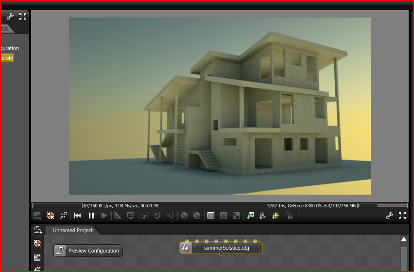

Hi and Thanks, I managed to find the problem Group entity, it was the 2 small roof knee braces that support the small roof located at the garage side man door. The roof was a Group that contained 2 the knee braces which were sub-group as well.

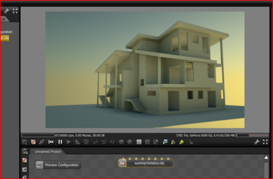

I need to correct what I said before, I can render a still frame but i'm still unable to render the solar animation, start scene is "summer solstice start", and the end scene is "summer soltice end"?
