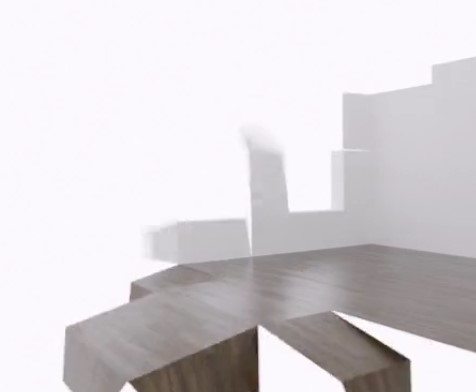

I have been testing some animation projects and have realised something:
Geometry with a displaced shader doesn't produce motionblur? Is that correct?
https://vimeo.com/514494921?fbclid=IwAR ... 3FSfKiRtAI
In this video, all the walls and ceiling have a not displaced white plaster. The wooden floor has it and I couldn't notice motion blur.
Please confirm ths is correct.

Kalua wrote:I have been testing some animation projects and have realised something:
Cheers,
Yes correct

Texture displacement does not support motion blur, but vertex displacement does. Vertex displacement requires a much higher density mesh to start with, however. You can read about it here:
https://docs.otoy.com/cinema4d/OSLVerte ... ement.html

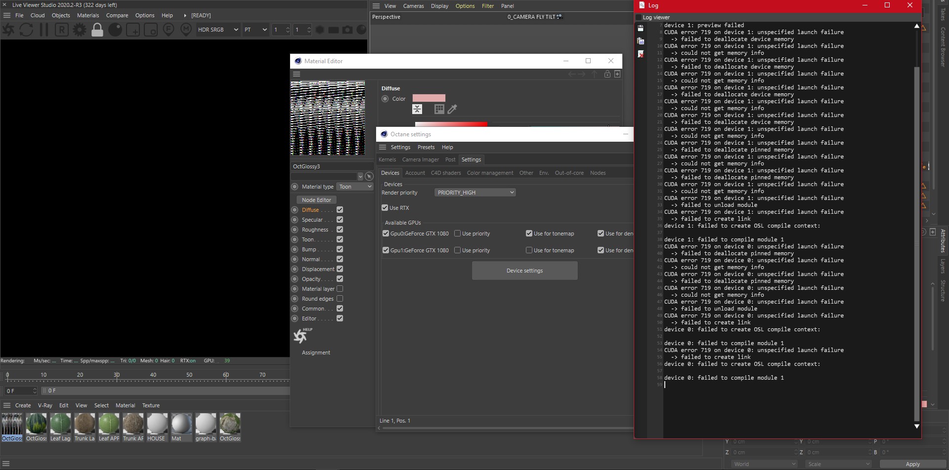

I don't know if anybody else has had this - in these last couple of 2020 releases, when the denoiser is applied the whole screen just goes black in the live viewer. MAC Cuda version -OSX 10.13.6

SRCOBB wrote:I don't know if anybody else has had this - in these last couple of 2020 releases, when the denoiser is applied the whole screen just goes black in the live viewer. MAC Cuda version -OSX 10.13.6
It happens to me randomly. Can't tell the pattern.

bepeg4d wrote:About 2020.2 Mac CUDA versions, sorry, there are issues in the core SDK with this version, and both AI Denoiser and AI Up Sampling are giving CUDA error 700 also in Standalone .
The core devs are investigating the issue, and will be fixed in the next update.

Hi Kalua and 3dworks,
in both cases, we need to wait for the upcoming 2020.2.1 SDK for a fix.
ciao Beppe

bepeg4d wrote:Hi Kalua and 3dworks,
ciao Beppe
Thank you, Beppe
Since we are on R3, I thought they were already solved.
