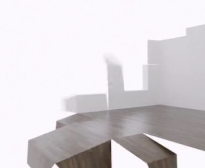

I have been testing some animation projects and have realised something:
Geometry with a displaced shader doesn't produce motionblur? Is that correct?
https://vimeo.com/514494921?fbclid=IwAR ... 3FSfKiRtAI
In this video, all the walls and ceiling have a not displaced white plaster. The wooden floor has it and I couldn't notice motion blur.
Please confirm ths is correct.
Cheers,
Wood Shader with displacement won't produce motion blur

Kalua wrote:I have been testing some animation projects and have realised something:
Cheers,
Yes correct
jayroth2020
Posts: 492
Joined: Mon May 04, 2020 7:30 pm
Texture displacement does not support motion blur, but vertex displacement does. Vertex displacement requires a much higher density mesh to start with, however. You can read about it here:
https://docs.otoy.com/cinema4d/OSLVerte ... ement.html

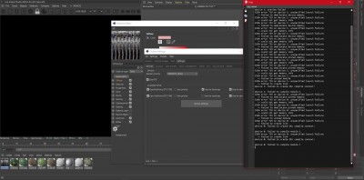

Kalua
Posts: 549
Location: Caribbean Sea
So, I have been using 2020.2 R3, and tried the toon shader: it keeps crashing Octane. I must close C4D and reopen it.
Regards,
Toon shader has issues

Hi Kalua and 3dworks,
in both cases, we need to wait for the upcoming 2020.2.1 SDK for a fix.
ciao Beppe
Kalua
Posts: 549
bepeg4d wrote:Hi Kalua and 3dworks,
ciao Beppe
Thank you, Beppe
Since we are on R3, I thought they were already solved.
