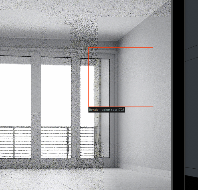

Another smal thing that has been going on with 2018.3-R2 and 4.05-R3: the render region is now offseting in relation to the red marquee drawn by the user. Is a random behavior, starts working fine until something makes it offset Take a look at the .gif.

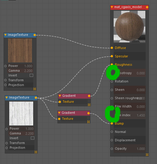

1.Why are the Anysotropic and Film index lacking the nodes entry?

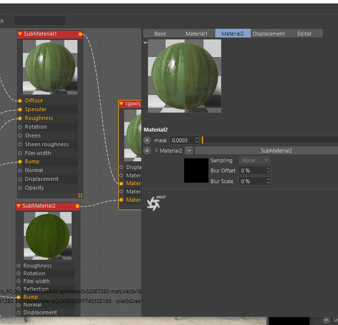

2.Blend Shader: there erros with the input values for mixing each material, looks like the plugin is multiplying the values I write .
2.Blend Shader: there erros with the input values for mixing each material, looks like he is multiplying the values I write .

1. They are just float values without having texture inputs.
2. It's a gui problem, I've fixed for next builds.
Cheers
i experience the same in r20 and with the latest 4.05 plug.
