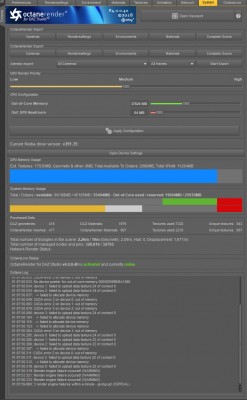

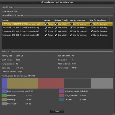

I thought this was over with Octane 4.0 ... today while rendering in DAZ:
00:45:47.225: +++++ Plugin running.
01:07:49.847: Failed to allocate page-locked memory
01:07:49.860: Failed to allocate page-locked memory
01:07:49.893: CUDA error 2 on device 1: out of memory
01:07:50.032: CUDA error 2 on device 2: out of memory
01:07:50.033: Failed to allocate page-locked memory
01:07:50.033: -> failed to allocate device memory
01:07:50.033: CUDA error 2 on device 3: out of memory
01:07:50.033: No device pointer for out-of-core memory 00000056BEBA1060
01:07:50.034: device 1: failed to upload data texture 24 of context 0
01:07:50.034: device 2: failed to upload data texture 24 of context 0
01:07:50.037: -> failed to allocate device memory
01:07:50.049: CUDA error 2 on device 0: out of memory
01:07:50.063: CUDA error 2 on device 1: out of memory
01:07:50.076: CUDA error 2 on device 2: out of memory
01:07:50.090: device 3: failed to upload data texture 24 of context 0
01:07:50.104: -> failed to allocate device memory
01:07:50.116: -> failed to allocate device memory
01:07:50.153: -> failed to allocate device memory
01:07:50.284: CUDA error 2 on device 3: out of memory
01:07:50.285: device 0: failed to upload data texture 24 of context 0
01:07:50.285: device 1: failed to upload data texture 22 of context 0
01:07:50.306: device 2: failed to upload data texture 22 of context 0
01:07:50.307: -> failed to allocate device memory
01:07:50.311: CUDA error 2 on device 0: out of memory
01:07:50.311: device 3: failed to upload data texture 22 of context 0
01:07:50.312: -> failed to allocate device memory
01:07:50.318: device 0: failed to upload data texture 22 of context 0
01:07:50.319: Render engine failure occured! (WARNING)
01:07:53.321: Render engine failure occured! (WARNING)
01:07:56.333: Render engine failure occured! (WARNING)
01:07:59.860: 3 render engine failures within a minute - giving up! (CRITICAL)

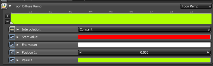

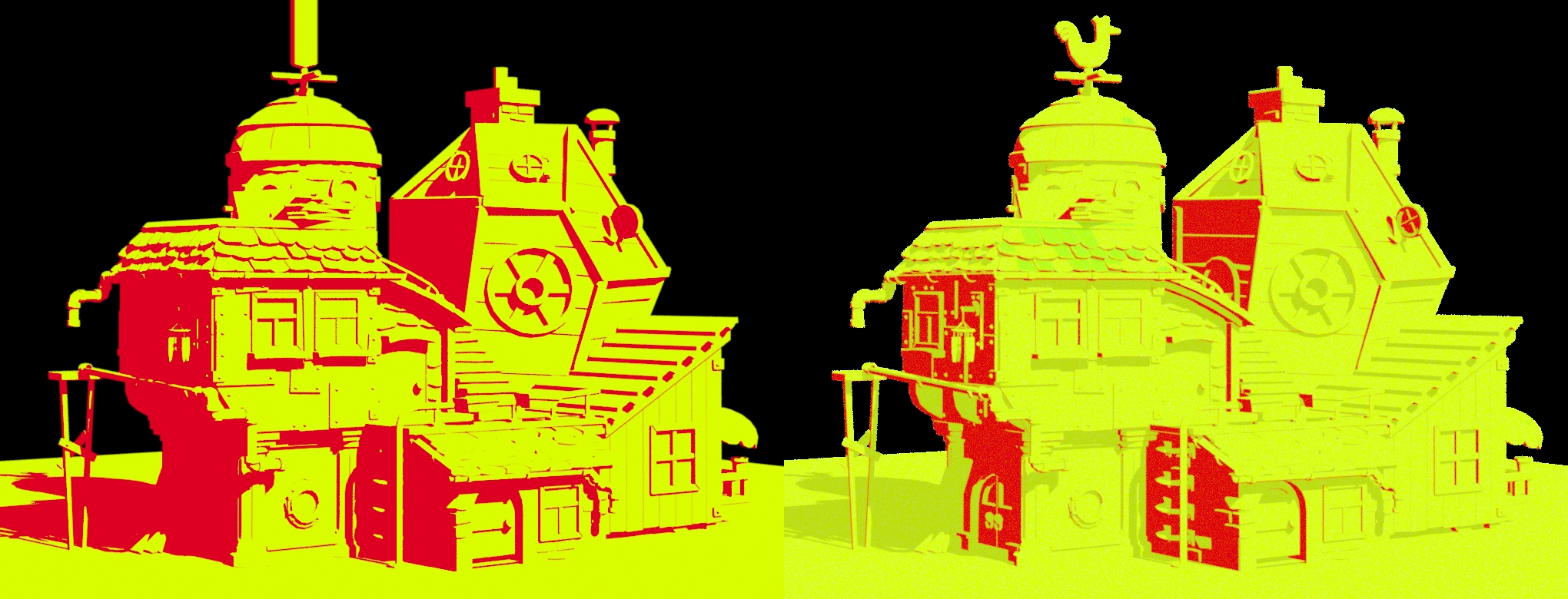

I have three suggestions for the Toon render.
1. Could you make it so that we have the option to use textures in side the 'Toon diffuse ramp'. Now we can only use colors (float), but a texture would be very useful here.
2. Could the 'Toon Diffuse Ramp' not only work on 'shading' but also on the shadows color (so an options shadows included maybe?) (this is how ramp-shaders in other packages work and is the most logical way in my opinion). (In the images I attached, the left one is the one I would want to make, the right one is the one octane lets me make).
3. Could you put the 'north offset' in the Toon direction light (just like in the normal sun direction). That would be great.
Thanks!
Thanks!
