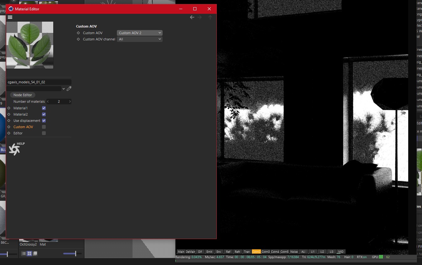

I think I found a small bug:
Unchecked "Custom AOV" in Composite shader shows on custom AOV layer.

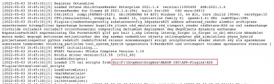

OctaneLog:
c4doctanelog.txt
(28.64 KiB) Downloaded 279 times
Master: WIN 10 64bit, i7 4930 4,5 Ghz, 64 GB RAM, 1600 W PSU, 1 TB SSD, 14 TB RAID, 2 x RTX 3090
Posts: 10611
Hi Ron,
the plugin is loaded from Dropbox, not good for stability:
Please install it correctly in C:\Program Files\Maxon\Cinema 4D R26\plugins\c4doctane (You have to create the plugins folder in lowercase!), and report back, thanks.
