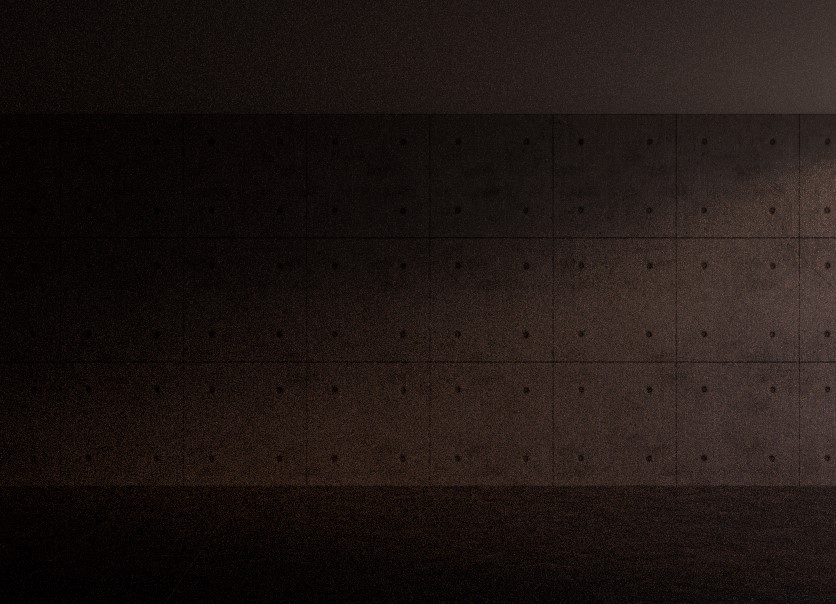

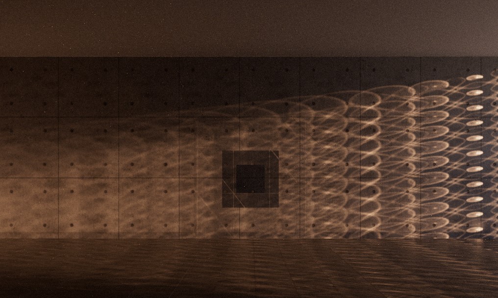

The difference is considerable.james_conkle wrote:Has anyone else noticed inconsistent behavior with the new photon kernel? I can snapshot the default settings, change them, go back to defaults, and even after reloading the intensity and distribution are different from the first render.

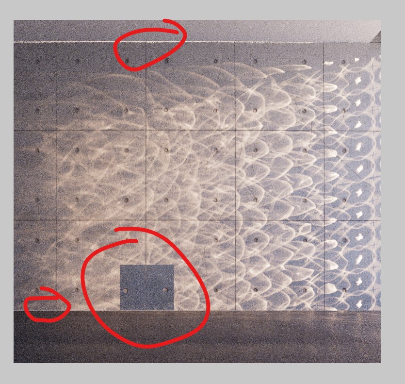

Displacement produces artifacts when caustics lights hit its surface (Photon engine).
Happens with various materials and scenes.

Yes. Ia had hard time finding the file. Found a similar one. I am uploading as I write. Check back your PM later.john_otoy wrote:Can you provide an ORBX so we can look into it? I've sent you a PM.Kalua wrote:Displacement produces artifacts when caustics lights hit its surface (Photon engine).

I looked at your scene and it was using a large ray epsilon of 0.1. After setting the kernel back to defaults, I'm not seeing any artifacts. If you still feel there is an issue, please reply to my PM and we'll look into it.Kalua wrote:Yes. Ia had hard time finding the file. Found a similar one. I am uploading as I write. Check back your PM later.john_otoy wrote:Can you provide an ORBX so we can look into it? I've sent you a PM.Kalua wrote:Displacement produces artifacts when caustics lights hit its surface (Photon engine).
