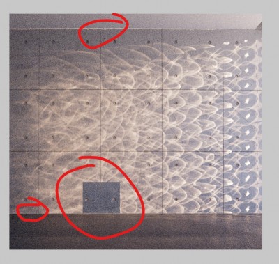

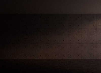

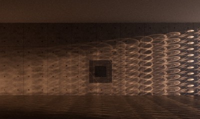

Displacement produces artifacts when caustics lights hit its surface (Photon engine).
Happens with various materials and scenes.
Photon tracing + displacement on wall + caustic glass produeces artifacts on displaced wall.
Path tracing engine
Path tracing engine

Kalua wrote:Displacement produces artifacts when caustics lights hit its surface (Photon engine).
Can you provide an ORBX so we can look into it? I've sent you a PM.
Yes. Ia had hard time finding the file. Found a similar one. I am uploading as I write. Check back your PM later.

Kalua wrote:
I looked at your scene and it was using a large ray epsilon of 0.1. After setting the kernel back to defaults, I'm not seeing any artifacts. If you still feel there is an issue, please reply to my PM and we'll look into it.
