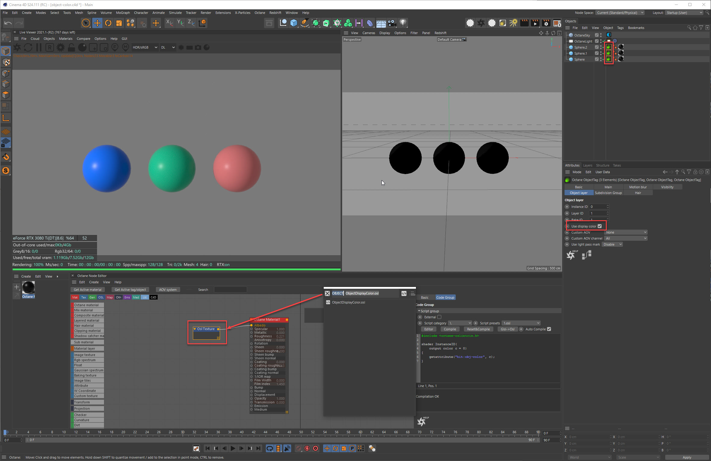

Hi Ahmet,
you added a neat feature with objectcolors. Can you shortly explain how does it works?
" - Added the usage for Object Layer color or display color parameters as texture color in materials "

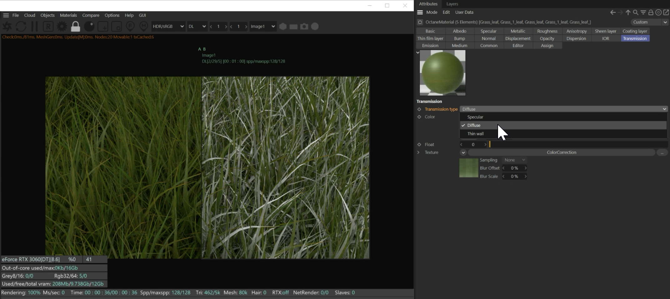

I'll be checking again in SA topic if I find any clued about these differences in reflections, while I'm attaching here a sample scene with grass to see what I mean about transmission. I attach even a couple of screenshots, so will be more clear.

Hi Luca,
the Universal material is not setup correctly, in particular, the Transmission popup should be set to Diffuse, not Specular, since you are mimic a Diffuse + reflections material, not a Specular material:
Diffuse Transmission on the left, Specular Transmission on the right.

Thanks a lot, Ahmet and Beppe!
I'll be fixing all the amterials I did for greenery :)

iDani wrote:Hi Ahmet,
cheers Daniel
I hope this image explains it well

Thank you Ahmet, it works and it is great for colorizing Renderinstances. Fantastic! :-)

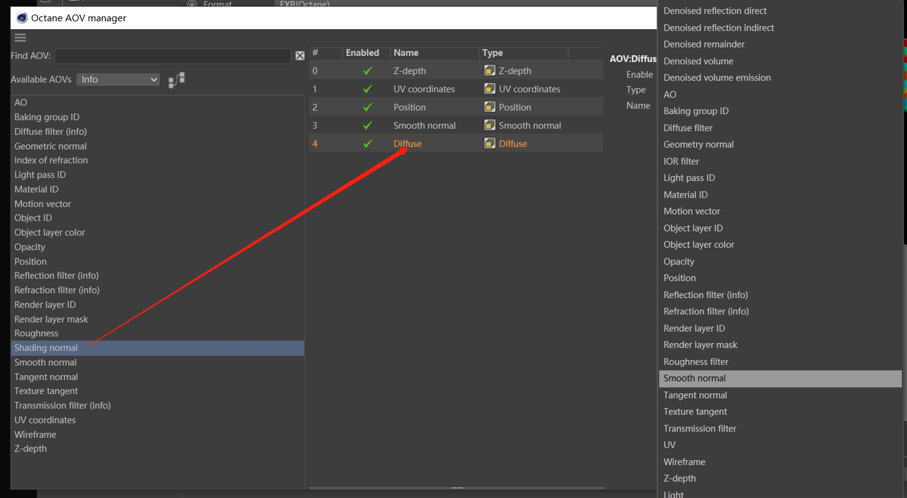

There seems to be a problem with the shading normal AOV,I choose shading normal but he gives me diffuse.
And can't find shading normal in the Type.
