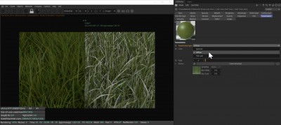

Hi Luca,
the Universal material is not setup correctly, in particular, the Transmission popup should be set to Diffuse, not Specular, since you are mimic a Diffuse + reflections material, not a Specular material:
Diffuse Transmission on the left, Specular Transmission on the right.
ciao,
Beppe

Thanks a lot, Ahmet and Beppe!
I'll be fixing all the amterials I did for greenery :)
Beppe, I'm really sad that you forgot my name, it's Marco :D

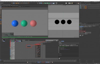

iDani wrote:Hi Ahmet,
you added a neat feature with objectcolors. Can you shortly explain how does it works?
" - Added the usage for Object Layer color or display color parameters as texture color in materials "
cheers Daniel
I hope this image explains it well
cheers Daniel
Thank you Ahmet, it works and it is great for colorizing Renderinstances. Fantastic! :-)

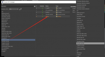

wangdanyang1120
Posts: 17
Joined: Tue Mar 26, 2019 9:49 am
There seems to be a problem with the shading normal AOV,I choose shading normal but he gives me diffuse.
And can't find shading normal in the Type.
