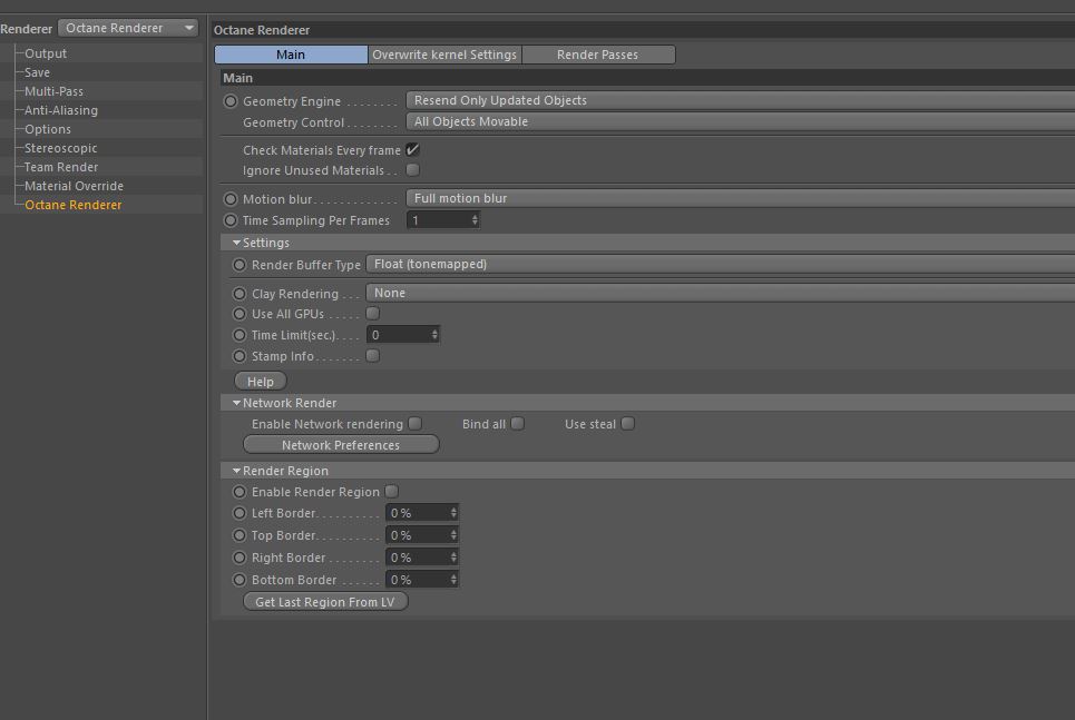

FxDesign wrote: No I did'nt change the render settings of octane, or xparticles.
Here is a screenshot, do you need my scene too ?
what about main tab?
The attachment Sans-titre-2.jpg is no longer available
I've changed nothing here too
