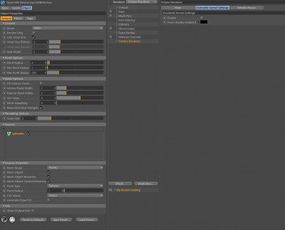

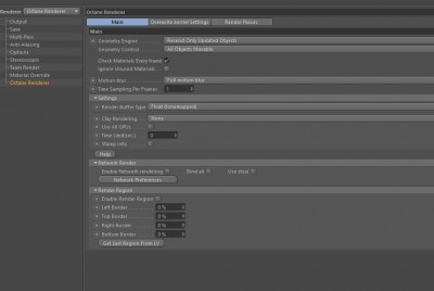

what about main tab?FxDesign wrote: No I did'nt change the render settings of octane, or xparticles. Here is a screenshot, do you need my scene too ?
Version 4.0-RC7-R4 (obsolete release candidate) 10.11.2018
I've changed nothing here tooaoktar wrote:what about main tab?FxDesign wrote: No I did'nt change the render settings of octane, or xparticles. Here is a screenshot, do you need my scene too ?
I think I need your scene to check.FxDesign wrote:Hello Aoktar,
I'm in a situation where the render in the live viewer is different than the picture viewer.
Let me explain
With Xparticles, I'm emitting particles from a shader, then I'm meshing these particles with an Ovdbmesher.
I'm using the vertex color tag in the diffuse to have the vdb colored. In the LV no problem, but in the final render, the Ovbmesher has no color.
Here is a preview of my workflow. Can you tell if I'm doing something wrong ?
Thank you
