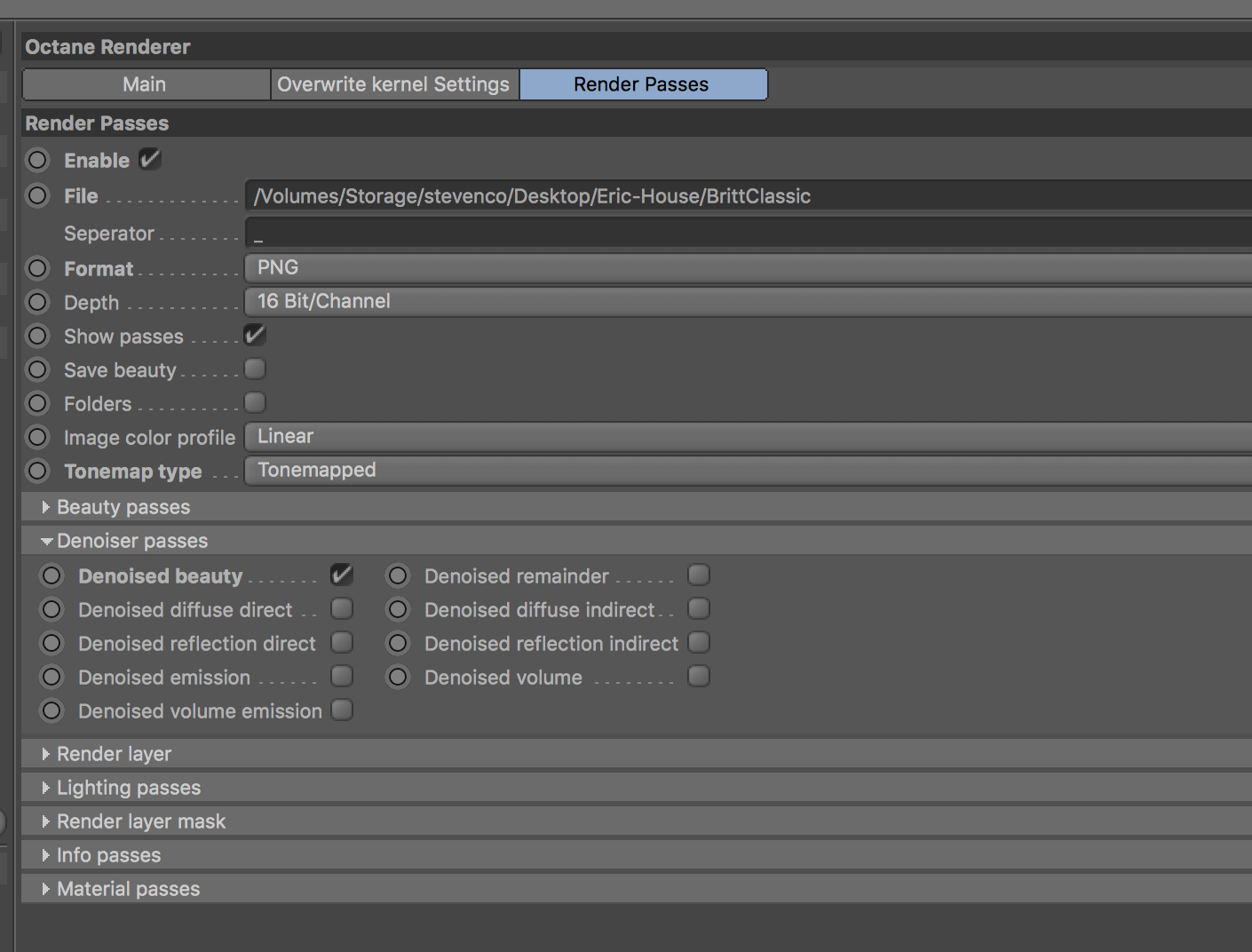

A specific pass? I've been trying to save denoised beauty. I also added a diffuse pass once just to see if anything would save. No luck. Just nothing happening. (denoise is definitely on in render settings, too, and showing in the live viewer)aoktar wrote:Are you talking all passes or specific one?SRCOBB wrote:Has anyone reported an issue with Octane render passes not being saved? The last 2 releases, I have it set to save denoised beauty pass and it does nothing.
I JUST got it to work by changing the path.. must have had something to do with the render path I had before.aoktar wrote:Are you talking all passes or specific one?SRCOBB wrote:Has anyone reported an issue with Octane render passes not being saved? The last 2 releases, I have it set to save denoised beauty pass and it does nothing.
Issue of saving renderpasses are fixed on latest builds. Please post if you find a troubled case.SRCOBB wrote:I JUST got it to work by changing the path.. must have had something to do with the render path I had before.aoktar wrote:Are you talking all passes or specific one?SRCOBB wrote:Has anyone reported an issue with Octane render passes not being saved? The last 2 releases, I have it set to save denoised beauty pass and it does nothing.
