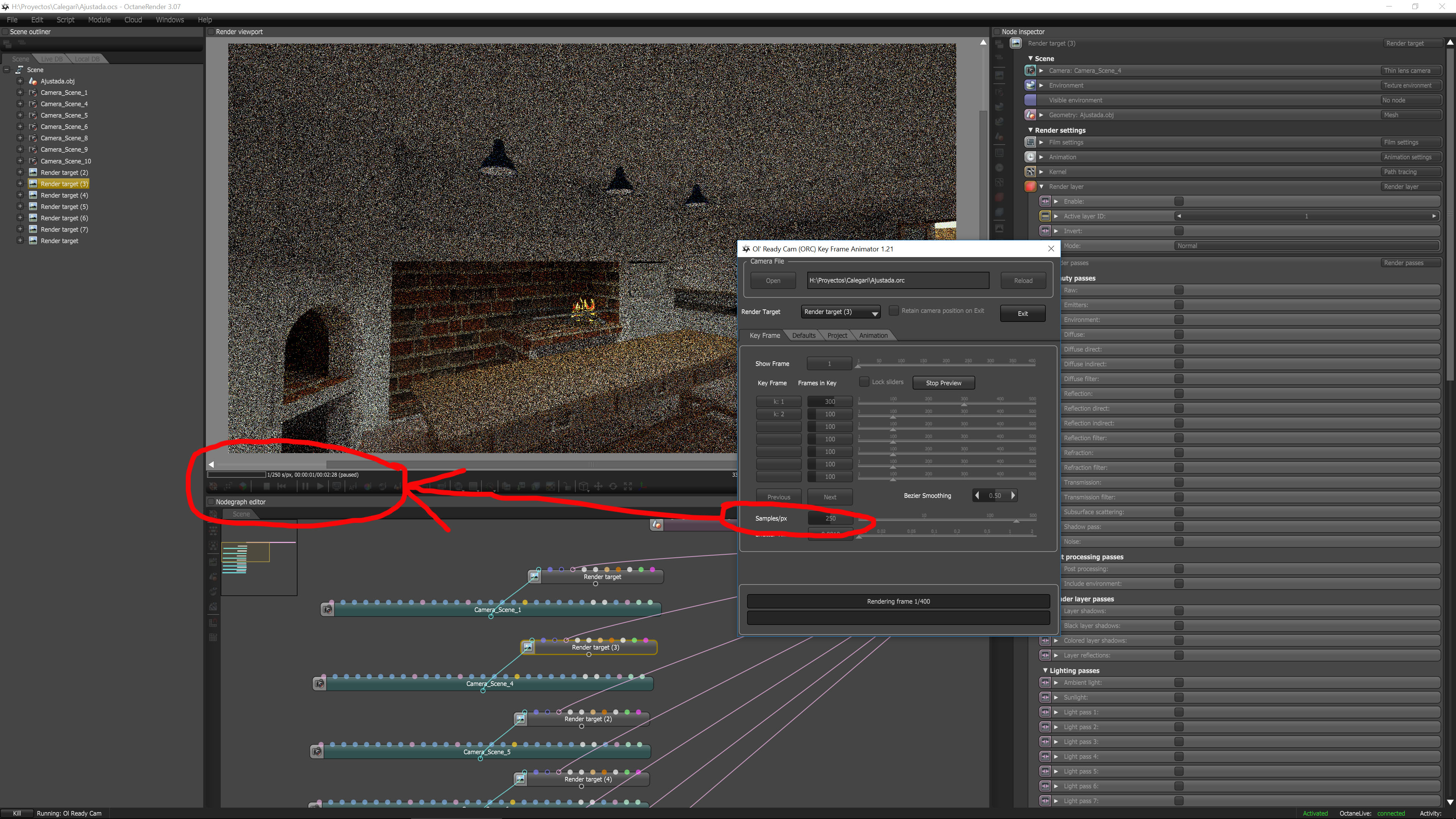

Ran into another roadblock..... ORC seems to pause after starting the first frame. I get the first frame saved but it is at like 2 sample quality. My adjustments to raise the samples has no affect, and additional frames are not attempted.
The other bug I ran into but found a workaround for was related to multiple render targets. My workaround has been to only use one render target and switch the cameras when creating frames for ORC.
If anyone has insight as to why my frames wont rendering, please let me know.

Thanks for looking into this Roeland, tried it with 3.07.
As Rederwiz mentions, everthing appears to work fine until I hit "render". It just renders the first frame to 1 sample and then stops.

Hi...I´m looking the Roeland 3.07...and having problems with Sample/pix....ORC just works with Sample/pix=1, when I put more (250) Octane says PAUSED
mlarregle
Posts: 2
Joined: Fri Aug 10, 2012 2:53 pm
Any workarround to fix these?
