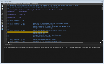

Please see screen shot from script editor.

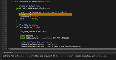

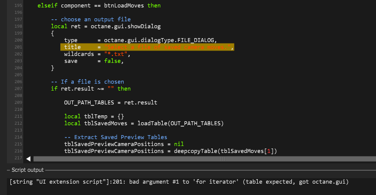

I am getting an error in the following code, which is the line setting the title value in a table holding PROPS_FILE_DIALOG attributes. I'm suspicious its not really being caused by that line. This script worked in versions prior to 3.06. any help would be appreciated.
thx.

Your suspicion is correct, that error is actually raised by a call to
Roeland
octane.gui.createGroup
. It expects a 2D table with components — technically a sequence of sequences of components , eg. {{label1, slider1}, {label2, texteditor2}, {label3, button3}}
. This represents how the components are laid out in a 2D grid.--

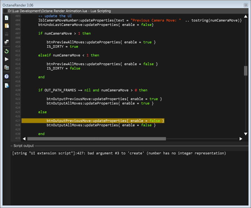

This is due to new behaviour in Lua 5.3. This version introduced a separate integer type, and where previously floating point numbers were implicitly rounded to integers, now this rounding will raise an error if the number in question is not an exact integer. For some situations (like array indices or type IDs) that's probably a good thing, but in other situations where this rounding kind of works OK (UI component sizes in the script above) it will break scripts.
You can fix this script by looking for instances of
We can emulate the old behaviour in a few places, so more scripts will still work.
Roeland
width=(cameraFile.group.width * .97)
and replacing them with width=math.floor(cameraFile.group.width * .97)
Roeland
