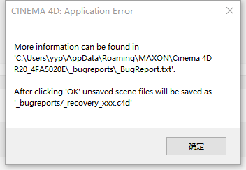

Critical_Log
[08:36:29] CRITICAL: Duplicate definition for net.maxonexample.cinema4dsdk
[object_impl.cpp(4477)]
[08:37:04] CRITICAL: Stop: This is not allowed, invoking call needs to be fixed. [xstring_impl.cpp(489)]
I had this problem opening a new project
- Attachments
- error .png (10.77 KiB) Viewed 5948 times

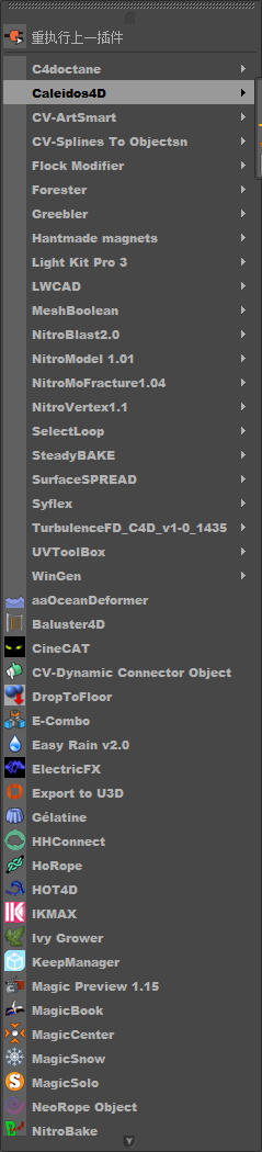

Not sure It's an Octane plugin issue. What do you have as plugins?YYP wrote:Critical_Log

In the morning the version of 2018.1.2 was doneaoktar wrote:Not sure It's an Octane plugin issue. What do you have as plugins?YYP wrote:Critical_Log
