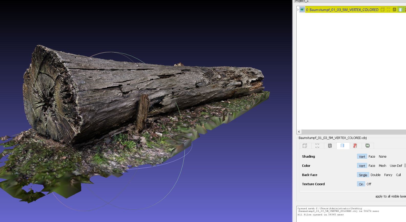

i have one ( stupid?) question:
the current version supports vertex attributes like "vertex color" i guess.
so how is it possible to use this meshinormation ( have a photoscanned model with generated vertexcolors in my project) for shadingpurposes (for example: transfer the vertexcolorinformation in the octane-diffusechanel instead of using large imagefiles)
thanks in advance an sorry for my lousy english
cheers
oli

useruser wrote:once again: thanks a lot for the new release and your hard work ahmet! :)
cheers
oli
It support it by following.
You should use "Vertex map" or "Vertex color" tags on meshes. And put a "Vertex map" shader to your materials by linking to these tags.

unfortunatley this is not exactly what i need. with the vertex-color tag you are able to paint inside c4d on vertex and then you are able to shade and render the mesh
with the vertexsmapshader.
but in my case the mesh hast already colorvertex-information, ( its a treetrunk, created with a photogrammetry-programm which also created the vertexcolors onto the mesh (attachment)
is it maybe possible to " read out" the existing vertexcolors with an osl-script or something like that?

@useruser, you should import these values as vertexmap tags. It's the way how we read vertex attributes. Vertexmap tag is for float and vertexcolor tag is for rgb vertex attributes.

aoktar wrote:@useruser, you should import these values as vertexmap tags. It's the way how we read vertex attributes. Vertexmap tag is for float and vertexcolor tag is for rgb vertex attributes.
thank you!
just for the record: until now i find two workflows for importing vertex colors for exmaple from obj-meshes into c4d : one is a plugin solution developed by rui batista called polpaint pack 1.5
http://ruimac.com/plugins.htm#20
the other method requires zbrush. just import the obj and export(convert) it via fbx-plugin from zbrush.
the native c4d fbx-importer is able to read the color vertex information and stores it into the vertexcolor-tag
