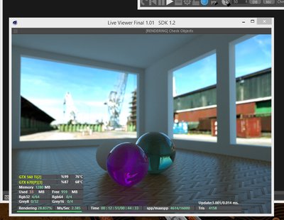

Ron wrote:Hi Aoctar,
V 1.01 is working fine for me under Win8.1 with R15. Thank you for all the effort you put in to develop this plugin. I appreciate it very much.
Two issues came up doing renders with V 1.01:
1) Saving images is not possible using the 'FILE/SAVE AS! dialog. No image is saved.
2) Rendered images using HDR environment force a lot of noise. I tried with many different methods but no clean result. Attached is an example image. Please have a look and let me know what is wrong.
Thanks and best regards
Ron

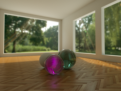

Ron, please check this sample scene
this is produced with 1.10, and texture scale looks little different but ok anyway.
interior1.rar
(3.06 MiB) Downloaded 298 times

aoktar wrote:Ron, please check this sample scene
I tried your scene but the result was noisy like before. I figured out that using Rainasawrus HDRI the renders are clean and without noise. With your or any other HDRI the results gonna get noisy.
What can be the reason for that?
BTW: I tuned down the hotpixel value to zero with no effect.

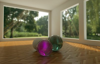

This is Ahmets sample szene on my machine after 1 min rendertime. Hotpixel slider was set to 1. Never touched that slider. In my opinion it gives bad results! Tryed ahmets HDR and rainsaws. no difference! Win 7 x64. c4d r15 with Octane 1.10! Maybe a win 8 problem?

Ron,
If you say that you got different result on this scene, really weird. It should be very similar as picture of CFrank. Can you put the output for this original scene?
This remind me a bad hdri images or wrong gamma settings. i think your setting is on for importance sampling, isn't?
Also save images was fixed a few million years ago. If you didn't reset render, it should work. Did you tried png8/16, exr outputs?

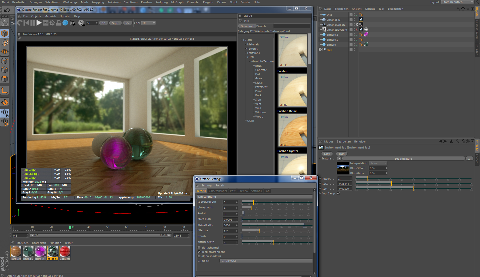

cfrank78
Posts: 328
Joined: Sat Nov 17, 2012 11:44 pm
Tryed it also in 1.01 1.20.3! I was curious! Same results like in 1.10, only texture and hdri looks of course difference, cause of new transforms!
Only 1.20.3 is a BIT faster! I get 13.3ms/sec in 1.20.3 hehe! In 1.10 it are 12.x
Seems to be a win 8.1 problem or your machine is not ok! Maybe another win 8.1 person can try!
Importance sampling on off can´t be this problem and also gamma and power cant be the problem ahmet, if he used your szene 1:1 and gets the same error and he said he did that!

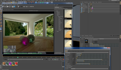

cyartist
Posts: 47
Joined: Wed Jun 02, 2010 5:54 pm
Here is a render on my machine. Win 7 64bit
