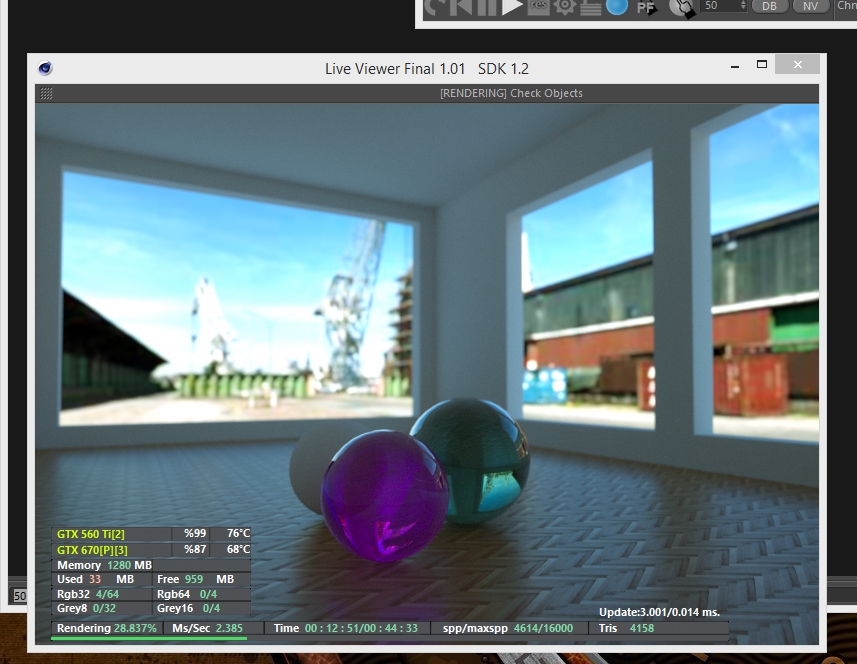

Did you adjust the hotspot slider at all? That does seem like a lot of noise for an HRDI regardlessRon wrote:Hi Aoctar,

2) Rendered images using HDR environment force a lot of noise. I tried with many different methods but no clean result. Attached is an example image. Please have a look and let me know what is wrong.
Thanks and best regards
Ron

No. What do you mean with 'hotspot slider'? Have not read about that in help files.SVITAdmin wrote: Did you adjust the hotspot slider at all? That does seem like a lot of noise for an HRDI regardless
Master: WIN 10 64bit, i7 4930 4,5 Ghz, 64 GB RAM, 1600 W PSU, 1 TB SSD, 14 TB RAID, 2 x RTX 3090
My apologies. I'm not in front of Octane right now. Its the Hotpixel slider under the Camera Imager tab in settings. i always keep that slider downRon wrote:No. What do you mean with 'hotspot slider'? Have not read about that in help files.SVITAdmin wrote: Did you adjust the hotspot slider at all? That does seem like a lot of noise for an HRDI regardless
Hot Pixel Removal: The Hot Pixel Removal slider is used to remove the bright pixels (fireflies) during the rendering process. While many of the pixels can dissappear if the render is allowed to progress, the Hot Pixel Removal feature allows the bright pixels to be removed at a much lower Sample per Pixel.

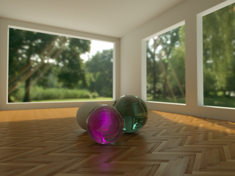

Ron, please check this sample scene
this is produced with 1.10, and texture scale looks little different but ok anyway.

I tried your scene but the result was noisy like before. I figured out that using Rainasawrus HDRI the renders are clean and without noise. With your or any other HDRI the results gonna get noisy.aoktar wrote:Ron, please check this sample scene
What can be the reason for that?
BTW: I tuned down the hotpixel value to zero with no effect.
Ron
PS: what about the save file as function? Any ideas why it is not working for me?
PS 2: Your scene with an Rainasawrus HDRI - clean and crisp

This is Ahmets sample szene on my machine after 1 min rendertime. Hotpixel slider was set to 1. Never touched that slider. In my opinion it gives bad results! Tryed ahmets HDR and rainsaws. no difference! Win 7 x64. c4d r15 with Octane 1.10! Maybe a win 8 problem?

Ron,
If you say that you got different result on this scene, really weird. It should be very similar as picture of CFrank. Can you put the output for this original scene?
This remind me a bad hdri images or wrong gamma settings. i think your setting is on for importance sampling, isn't?
Also save images was fixed a few million years ago. If you didn't reset render, it should work. Did you tried png8/16, exr outputs?
Tryed it also in 1.01 1.20.3! I was curious! Same results like in 1.10, only texture and hdri looks of course difference, cause of new transforms!
Only 1.20.3 is a BIT faster! I get 13.3ms/sec in 1.20.3 hehe! In 1.10 it are 12.x
Seems to be a win 8.1 problem or your machine is not ok! Maybe another win 8.1 person can try!
Importance sampling on off can´t be this problem and also gamma and power cant be the problem ahmet, if he used your szene 1:1 and gets the same error and he said he did that!
Chris!
