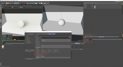

when i turn off the camera visibility ,shadow pass seems not the right result. :roll:

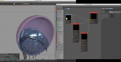

nycjunglist wrote:I've been using 3.06 Test4 in production for about 2-3 weeks now, and it's been pretty solid. I needed the motion blur support for Realflow fluids, so thank you for that, aoktar. Two things:
1) It seems that with the Folders option enabled in the Render Passes settings, if you use a token as a directory name, an extra folder with the token name will be created. Everything seems to save as normal in the proper directory though.
2) Is there support for Realflow wetmaps? If so, how can they be used?
The attachment octane-settings-306.jpg is no longer available
1) I could not reproduce that on first try but I'll check later.
2) I need to check this but its propably a kind of vertexmap. Right?
I don't believe the Wetmap is vertex-based. If you cache a Realflow sim with wetmaps enabled, it'll bake out the map as a PNG image sequence.
http://support.nextlimit.com/display/RFC4D/WetMaps
After some testing, I realized that you can just use the image sequence in an ImageTexture node. I guess that the C4D Octane plugin doesn't interpret the WetMap shader in the same way the native C4D materials do.

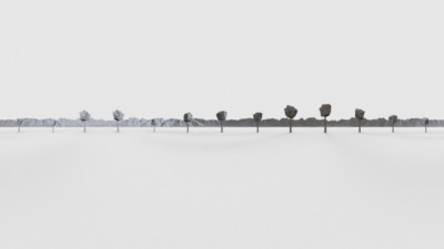

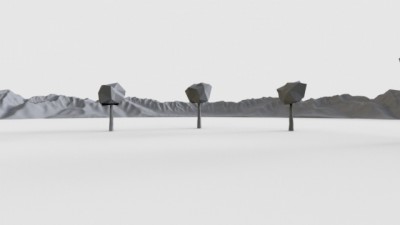

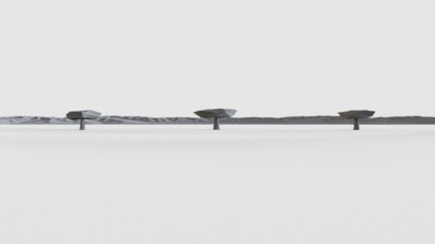

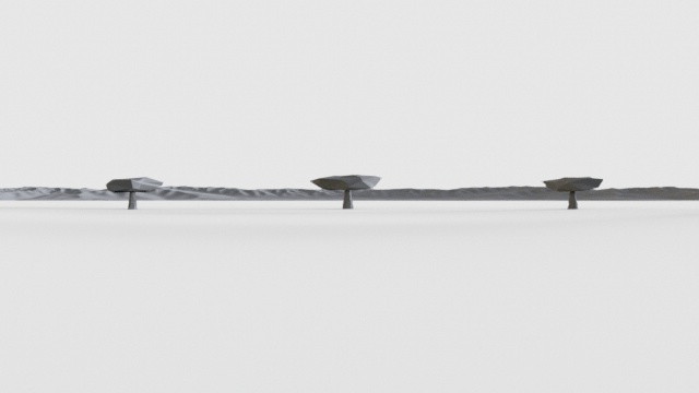

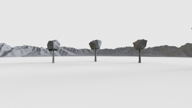

Hello,
In 3.06 Panoramic/Spherical camera does not work together with motion blur enabled!
(when mb is enabled I get a field of view of 90 degrees)
This worked well in 3.05.
Also the cylindrical camera does not work at al in 3.06
Can this be fixed?
Thanks, Andreas.
Spherical with motionblur
Spherical no motionblur
Thinlens
Thinlens

zxctnt wrote:when i turn off the camera visibility ,shadow pass seems not the right result. :roll:
It's a renderer issue. I'll ask for that.
