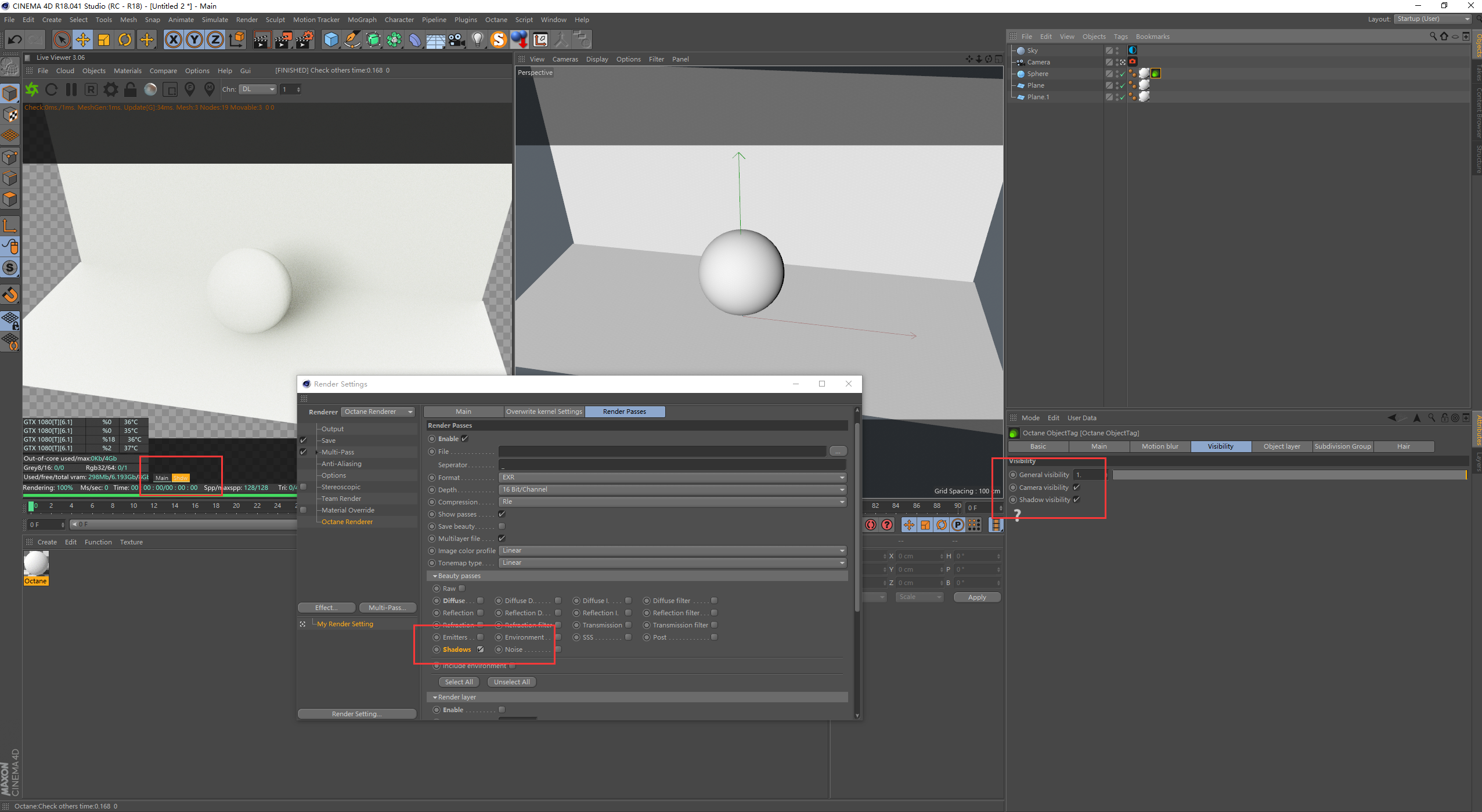

Thanks, Andreas.
It's a renderer issue. I'll ask for that.zxctnt wrote:when i turn off the camera visibility ,shadow pass seems not the right result.
