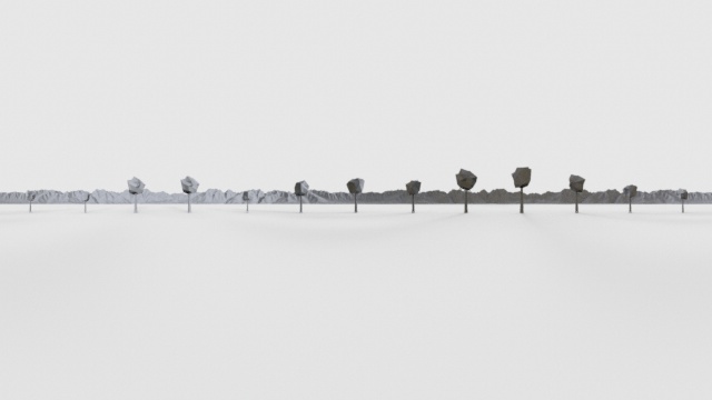

Hello,
In 3.06 Panoramic/Spherical camera does not work together with motion blur enabled!
(when mb is enabled I get a field of view of 90 degrees)
This worked well in 3.05.
Also the cylindrical camera does not work at al in 3.06
Can this be fixed?
Thanks, Andreas.
Can this be fixed?
Thanks, Andreas.
