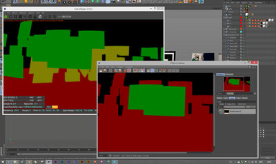

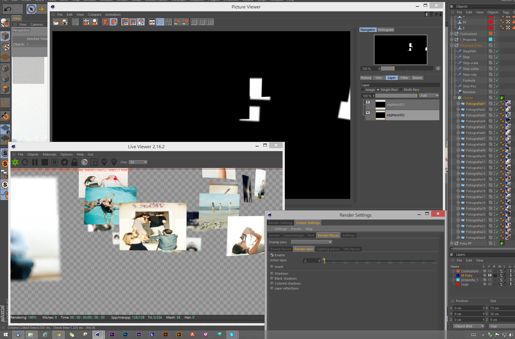

Hi, i've some trouble with layer mask when i render to picture viewer.
the result is incorrect.
have some1 else noticed that?
Seems he stop calculating after 31 passes
Thanks.

insertcoin wrote:Hi, i've some trouble with layer mask when i render to picture viewer.
Thanks.
Version? Have you watched the passes tutorial?

i've seen that in 2.16.2 there is no voice under render setting for separate id layer mask.
So after watching tutorial found here : http://inlifethrill.com/trainings/octan ... ayer-mask/
i tried 2.22.2 test3 where menu render pass layer is present.
And yes, i've seen all possible tutorial.
I'm trying for two hours now.. but i can't see how to... and we are close to deadline..
thanks
Scene_bug.zip
Here the cleaned scene
(85.81 KiB) Downloaded 311 times
As you can see, two renders are different for layer id also
